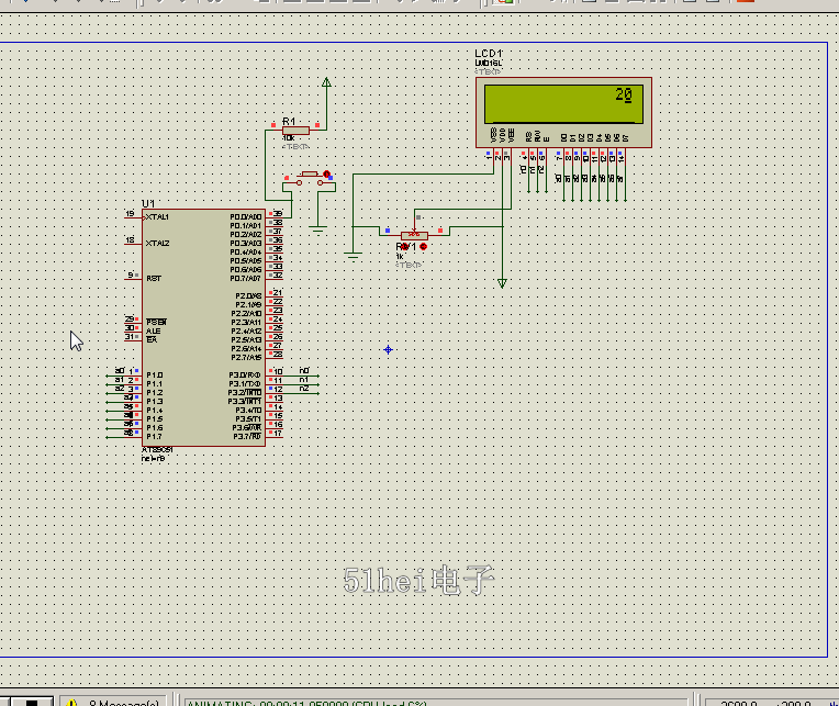

基于51单片机的24秒倒计时液晶显示程序Proteus仿真图
#include  "reg51.h"
#include<intrins.h>
sbit S1=P0^0;
unsigned char count=0;
unsigned char miao=24;
sbit RS=0xb0;
sbit RW=0xb1;
sbit E=0xb2;
unsigned char lcd[]={'0','1','2','3','4','5','6','7','8','9'};
void lcd_w_cmd(unsigned char com);
void lcd_w_dat(unsigned char dat);
unsigned char lcd_r_start();
void lcd_int();
void delay(unsigned int i);
void delay1();
void delay1()
  _nop_();
  _nop_();
  _nop_();
void lcd_int()
  lcd_w_cmd(0x3c);
  lcd_w_cmd(0x0e);
  lcd_w_cmd(0x01);
  lcd_w_cmd(0x06);
  lcd_w_cmd(0x80);
  unsigned char s;
  RW=1;
  delay1();
  RS=0;
  delay1();
  E=1;
  delay1();
  s=P1;
  delay1();
  E=0;
  delay1();
  RW=0;
  delay1();
  return(s);
  unsigned char i;
  do{
    i=lcd_r_start();
    i=i&0x80;
    delay(2);
     }while(i!=0);
  RW=0;
  delay1();
  RS=0;
  delay1();
  E=1;
  delay1();
  P1=com;
  delay1();
  E=0;
  delay1();
  RW=1;
  delay(255);
  unsigned char i;
  do{
    i=lcd_r_start();
    i=i&0x80;
    delay(2);
      }while(i!=0);
  RW=0;
  delay1();
  RS=1;
  delay1();
  E=1;
  delay1();
  P1=dat;
  delay1();
  E=0;
  delay1();
  RW=1;
  delay(255);
  unsigned int k;
for(k=0;k<i;k++);
void timer_1() interrupt 3
   TH1=(65536-50000)/256;
   TL1=(65536-50000)%256;
    if(S1==0)
                delay(1200);
                if(S1==0)
                {miao=24;}
         count++;
   if(count==20)
      count=0;
      miao--;
      if(miao==0)
                        {miao=24;
void main()
   TMOD=0x10;
   ET1=1;
   EA=1;
   TR1=1;
   P1=0xff;
   lcd_int();
   delay(255);
   lcd_w_cmd(0x8e);
   lcd_w_dat(lcd[miao/10]);
         lcd_w_cmd(0x8f);
         lcd_w_dat(lcd[miao%10]);
         delay(255);
