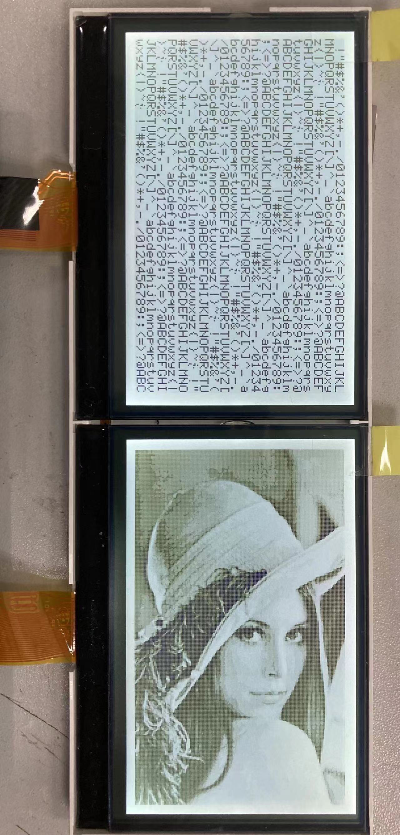

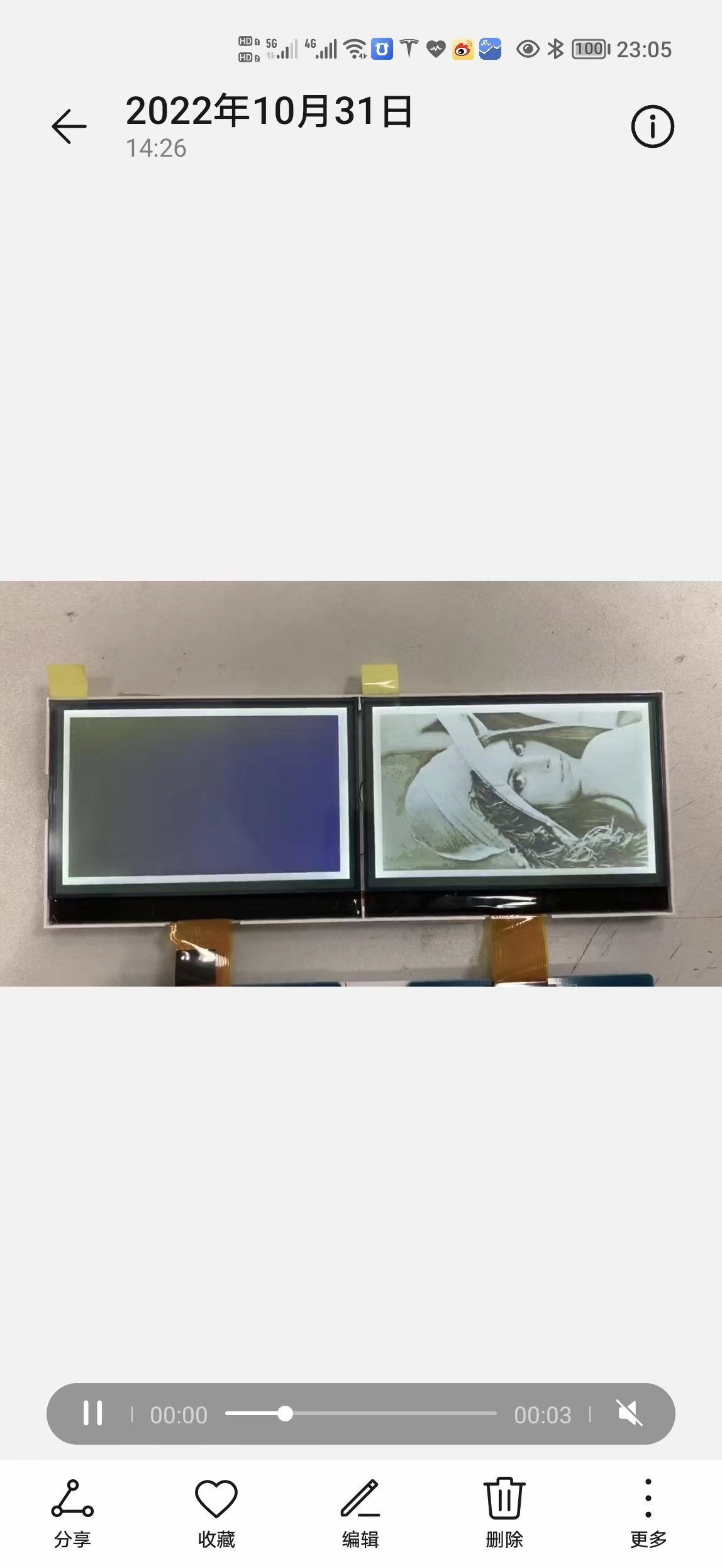

16灰阶LCM 270X160分辨率FSTN液晶显示屏LCD,ST7586S驱动,6800接口,单块屏3.5英寸,7寸LCM单色屏,可以黑白,4灰阶,16灰阶

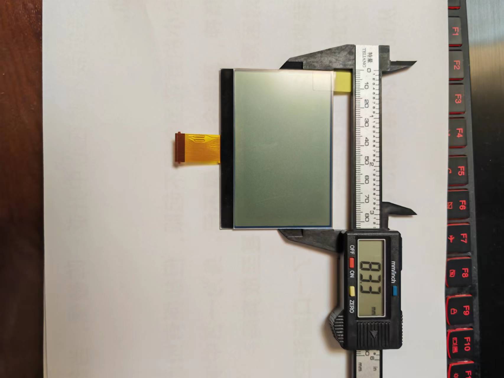

外形尺寸:170mmx62mm
玻璃尺寸:167mmx60mm
FPC软排线长度:23mm
单块玻璃尺寸:83.3mmx60mm
两块玻璃对角线尺寸:178mm
7寸LCM单色屏,FSTN屏,双屏显示,单块屏3.5英寸,3.5寸 LCD,270*160分辨率FSTN显示屏,ST7586S驱动,6800接口 10800个
LCD4310021001185001DED   ,D18110008,14966-LED-C-A173-20181106 ROHS
GWMS14966 CSM14966D CSM14966D(R)汕头超声液晶显示屏 LCD LCM
3.5寸液晶显示屏,270160 LCD 270X160 LCM 270*160显示屏 3.5英寸屏幕
270X160 高点阵,大尺寸液晶显示屏,双屏显示,单个屏幕3.5英寸,ST7586S,COG液晶模块 LCM LCD 单色屏 STN 6800接口
STM32单片机源程序如下:
  1. #include "S6B0724_i68.h"
  2. //#include <stdlib.h>
  3. #include <string.h>
  4. #include <stdio.h>
  5. #include "delay.h"
  6. #include "picture.h"
  7. #include "font5x8.h"
  8. #define LCD_WIDTH 270
  9. #define LCD_PAGE  20
  10. //#define LCD_PORT GPIOB
  11. #define CS1_CLR  GPIO_ResetBits(GPIOC, GPIO_Pin_6)
  12. #define CS1_SET  GPIO_SetBits(GPIOC, GPIO_Pin_6)
  13. #define DC1_CLR  GPIO_ResetBits(GPIOC, GPIO_Pin_7)
  14. #define DC1_SET  GPIO_SetBits(GPIOC, GPIO_Pin_7)
  15. #define RW1_CLR  GPIO_ResetBits(GPIOC, GPIO_Pin_8)

  104. }
  105. void lcd_send_cmd(unsigned int cmd)
  106. {
  107.         lcd_send_cmd1(cmd);
  108.         lcd_send_cmd2(cmd);
  109. }
  110. void lcd_send_data(unsigned int dat)
  111. {
  112.         lcd_send_data1(dat);
  113.         lcd_send_data2(dat);
  114. }
  115. void lcd_reset(void)
  116. {
  117.         lcd_reset1(); lcd_reset2();
  118. }
  119. void lcd_init_registers(void)
  120. {
  121.         //lcd_send_cmd(0x01);        //soft reset
  122.         //delay_ms(120);
  123.         lcd_send_cmd(0x11);                //sleep out
  124.         lcd_send_cmd(0x28);                //display off
  125.         delay_ms(25);
  126.
  127.         lcd_send_cmd(0xC0);
  128.         lcd_send_data(0x50);
  129.         lcd_send_data(0x01);
  130.
  131.         lcd_send_cmd(0xC3);
  132.         lcd_send_data(0x00);
  133.
  134.         lcd_send_cmd(0xC4);
  135.         lcd_send_data(0x07);
  136.
  137.         lcd_send_cmd(0xD0);
  138.         lcd_send_data(0x1D);
  139.
  140.         lcd_send_cmd(0xB3);
  141.         lcd_send_data(0x00);
  142.
  143.         lcd_send_cmd(0xB5);
  144.         lcd_send_data(0x00);
  145.
  146.         lcd_send_cmd(0x39);        //mono mode
  147.
  148.         lcd_send_cmd(0x3A);
  149.         lcd_send_data(0x02);
  150.
  151.         lcd_send_cmd(0x36);
  152.         lcd_send_data(0x00);        // COM:C159->C0   SEG: SEG383->SEG0
  153.
  154.         lcd_send_cmd(0xB1);
  155.         lcd_send_data(0x00);
  156.
  157.         lcd_send_cmd(0xB0);        //duty
  158.         lcd_send_data(0x9F);
  159.         lcd_send_cmd(0x20);
  160.         lcd_send_cmd(0x2A); // Column Address Setting
  161.         lcd_send_data(0x00); // COL0 -> COL127
  162.         lcd_send_data(0x13); //
  163.         lcd_send_data(0x00); //
  164.         lcd_send_data(0x6C); // 80*3=240 pixels
  165.         lcd_send_cmd(0x2B); // Row Address Setting
  166.         lcd_send_data(0x00); // ROW0 -> ROW159
  167.         lcd_send_data(0x00); //
  168.         lcd_send_data(0x00); //
  169.         lcd_send_data(0x9F); // 160 pixels
  170.
  171.         lcd_send_cmd(0x29);
  172. }
  173. uint8_t offsets[] = {6, 3, 0};
  174. void lcd_update(void)
  175. {
  176.         lcd_send_cmd(0x2A); // Column Address Setting
  177.         lcd_send_data(0x00);
  178.         lcd_send_data(0x13);
  179.         lcd_send_data(0x00);
  180.         lcd_send_data(0x6C);
  181.
  182.         lcd_send_cmd(0x2B); // Row Address Setting
  183.         lcd_send_data(0x00);
  184.         lcd_send_data(0x00);
  185.         lcd_send_data(0x00);
  186.         lcd_send_data(0x9F);
  187.
  188.         lcd_send_cmd(0x2C);
  189.

  228. void lcd_graphic_test(void)
  229. {
  230.         int i, j;
  231.
  232.         //display chess pattern
  233.         for(j=0; j< LCD_PAGE; j++)
  234.         {
  235.                 for(i=0; i< LCD_WIDTH; i++)
  236.                 {
  237.                         lcd_set_buffer(i, j, (i/4)%2 ? 0xF0 : 0x0F);
  238.                 }
  239.         }
  240.         lcd_update();
  241.         delay_ms(1000);
  242.
  243.         //all black.
  244.         for(j=0; j< LCD_PAGE; j++)
  245.         {
  246.                 for(i=0; i< LCD_WIDTH; i++)
  247.                 {
  248.                         lcd_set_buffer(i, j, 0xFF);
  249.                 }
  250.         }
  251.         lcd_update();
  252.         delay_ms(1000);
  253.
  254.         //all white.
  255.         for(j=0; j< LCD_PAGE; j++)
  256.         {
  257.                 for(i=0; i< LCD_WIDTH; i++)
  258.                 {
  259.                         lcd_set_buffer(i, j, 0x00);
  260.                 }
  261.         }
  262.         lcd_update();
  263.         delay_ms(1000);
  264.         int nCharIndex = 0;
  265.         for(int i=0; i< 20; i++)
  266.         {
  267.                 for(int j=0; j< 270; j++)
  268.                 {
  269.                         nCharIndex = (i*45 + j/6) % 96;
