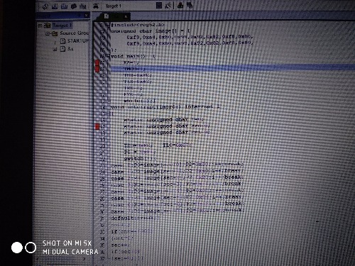

显示一个8-1不断右移的动态数码管,请大家帮忙看一下哪里有错
作者: jjjjj621    时间: 2018-6-22 23:41
这个照片压缩的有点模糊啊
作者: jjjjj621    时间: 2018-6-22 23:46
#include<reg52.h>unsigned char image[] = {         0xf9,0xa4,0xb0,0x99,0x92,0x82,0xf8,0x80,         0xf9,0xa4,0xb0,0x99,0x92,0x82,0xf8,0x80,};void main()  {        EA=1;         TMOD=1;        TH0=0xFC;        TL0=0x67;        TR0=1;        ET0=1;        while(1);}void interrupttimer0() interrupt 1{    static unsigned char i=0;        static unsigned char sec=0;         static unsigned char cnt=0;        TH0=0xFC;                TL0=0x67;        P0 = 0xff;                switch(i){case 0:P0=image[sec+0];P2=0x80;i++;break; case 1:P0=image[sec+1];P2=0x40;i++;break;case 2:P0=image[sec+2];P2=0x20;i++;break;case 3:P0=image[sec+3];P2=0x10;i++;break;case 4:P0=image[sec+4];P2=0x08;i++;break;case 5:P0=image[sec+5];P2=0x04;i++;break;case 6:P0=image[sec+6];P2=0x02;i++;break;case 7:P0=image[sec+7];P2=0x01;i=0;break;default:break;}cnt++;if(cnt==1000){cnt=0;sec++;if(sec>8){sec=0;}}}
