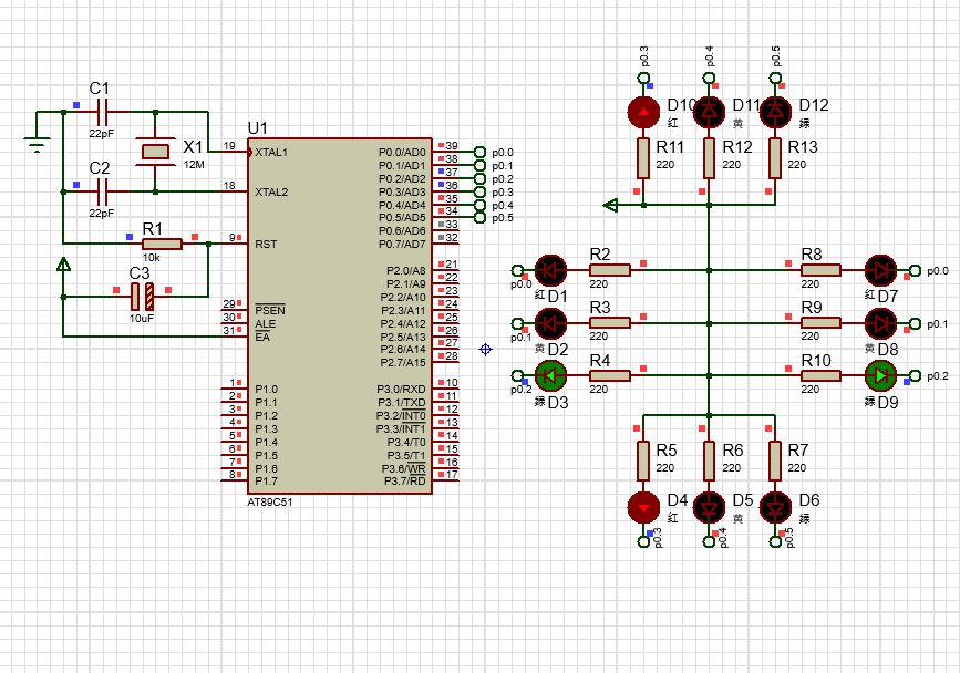

[attach]162988[/attach][attach]162988[/attach]附件里有仿真和源程序
#include <reg52.h>
#define uchar unsigned char
#define uint unsigned int
sbit RED_A=P0^0;
sbit YELLOW_A=P0^1;
sbit GREEN_A=P0^2;
sbit RED_B=P0^3;
sbit YELLOW_B=P0^4;
sbit GREEN_B=P0^5;
uchar Flash_Count = 0;
Operation_Type = 1;
void DelayMS(uint x)
         uchar t;
        while(x--)
                 for(t=120;t>0;t--);
void Traffic_lignt()
         switch(Operation_Type)
                 case 1:
                        RED_A=1;YELLOW_A=1;GREEN_A=0;
                        RED_B=0;YELLOW_B=1;GREEN_B=1;
                        DelayMS(5000);
                        Operation_Type = 2;
                        break;
                case 2:
                        DelayMS(500);
                        YELLOW_A=~YELLOW_A;
                        if(++Flash_Count !=10)
                                return;
                        Flash_Count=0;
                        Operation_Type = 3;
                        break;
                case 3:
                        RED_A=0;YELLOW_A=1;GREEN_A=1;
                        RED_B=1;YELLOW_B=1;GREEN_B=0;
                        DelayMS(5000);
                        Operation_Type = 4;
                        break;
                case 4:
                        DelayMS(500);
                        YELLOW_B=~YELLOW_B;
                                return;
                        Flash_Count=0;
                        Operation_Type = 1;
                        break;
void main()
                 Traffic_lignt();

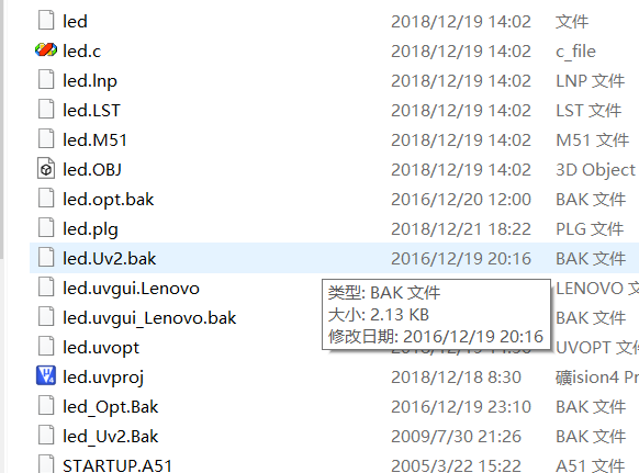

05 LED模拟交通灯.rar
61.06 KB, 下载次数: 8, 下载积分: 黑币 -5
