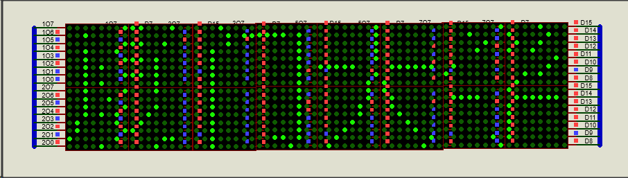

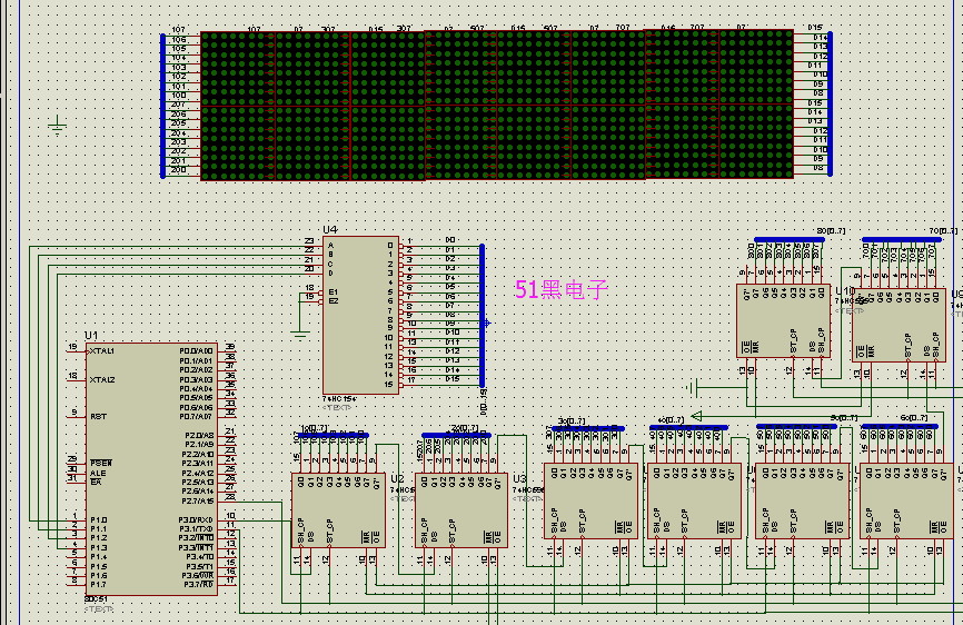

标题: 16*64汉字点阵显示仿真原理图+单片机代码 [打印本页]
作者: 啊啊啊哒哒哒啊    时间: 2018-12-22 12:37

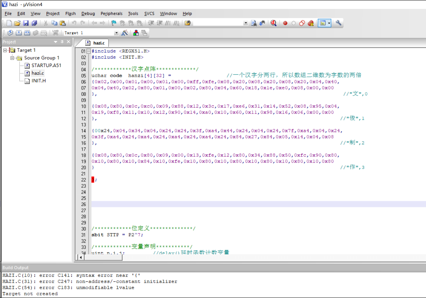

  1. #include <REGX51.H>
  2. #include <INIT.H>
  3. /************汉字点阵*************/
  4. uchar code        hanzi[4][32] =                                         //一个汉字分两行,所以数组二维数为字数的两倍
  5. {0x02,0x00,0x01,0x00,0x01,0x00,0xff,0xfe,0x08,0x20,0x08,0x20,0x08,0x20,0x04,0x40,
  6. 0x04,0x40,0x02,0x80,0x01,0x00,0x02,0x80,0x04,0x60,0x18,0x1e,0xe0,0x08,0x00,0x00
  7. },                                                                                //"文",0
  8. {0x08,0x80,0x0c,0xc0,0x09,0x88,0x12,0x3c,0x17,0xe6,0x31,0x14,0x52,0x08,0x95,0x04,
  9. 0x19,0xf8,0x11,0x10,0x12,0x90,0x14,0xa0,0x10,0x60,0x11,0x98,0x16,0x06,0x00,0x00
  10. },                                                                               //"俊",1
  11. {00x24,0x04,0x34,0x04,0x24,0x24,0x3f,0xa4,0x44,0x24,0x04,0x24,0x7f,0xa4,0x04,0x24,
  12. 0x3f,0xa4,0x24,0xa4,0x24,0xa4,0x24,0xa4,0x24,0x84,0x27,0x84,0x05,0x14,0x04,0x08
  13. },                                                                               //"制",2

作者: fangliang    时间: 2020-5-5 20:51
仿真效果不是很好
作者: fangliang    时间: 2020-5-5 22:32
太差劲了,程序都编译不了,最基本的位定义都搞错了,还有里面的字模和仿真里面的都不一样
