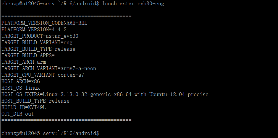

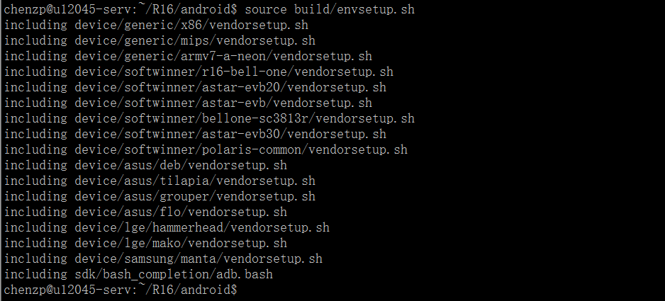

$cd ~/R16/android
$source build/envsetup.sh
$lunch astar_evb30-eng

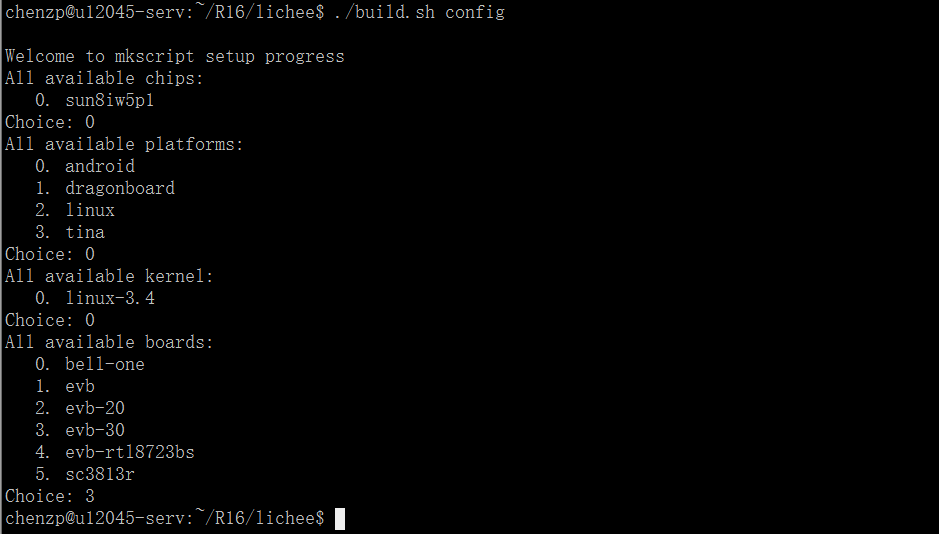

$cd ~/R16/lichee/
$./build.sh config
Welcome to mkscript setup progress
All available chips:
0. sun8iw5p1
Choice: 0
All available platforms:
0. android
1. dragonboard
2. linux
3. tina
Choice: 0
All available kernel:
0. linux-3.4
Choice: 0
All available boards:
0. bell-one
1. evb
2. evb-20
3. evb-30
4. evb-rtl8723bs
5. sc3813r
Choice: 3

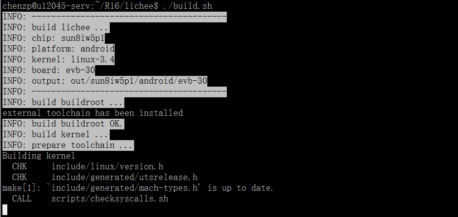

4.2  编译内核
$cd ~/R16/lichee
$./build.sh

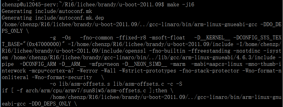

4.3  编译Uboot
$cd ~/R16/lichee/brandy/u-boot-2011.09/
$make distclean
$make sun8iw5p1_config
$make

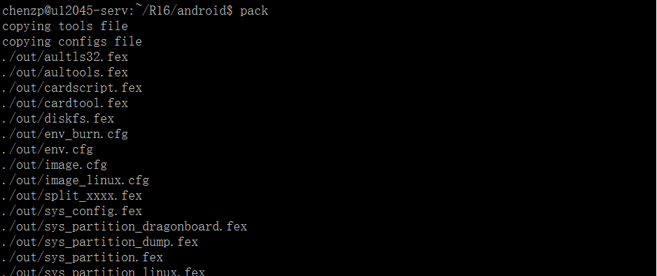

6  打包
$cd ~/R16/android
$pack
打包的最终文件在~/R16/lichee/tools/pack下的sun8iw5p1_android_evb-30_uart0.img
将该文件复制到电脑上就可以烧写到开发板上。烧写请参考《R16烧录手册》。
