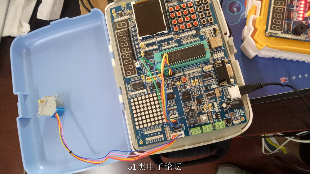

电路应该是这样连的吧?

我的这一个是用uln2003驱动电路的
  1. #include <reg52.h>
  3. sbit jia_key=P3^7;         //定义加键
  4. sbit jian_key=P3^6;          //定义减键
  5. sbit zf_key=P3^5;          //定义正反键
  6. //sbit dula=P2^6;                  //数码管段选端定义
  7. //sbit wela=P2^7;                  //数码管位选端定义
  8. bit flag=0;                          //定义正反转的
  9. uchar num=0,show_num=2,maichong=4,table_begin=0;
  10. uchar code table1[]={0x01,0x02,0x04,0x08,0x08,0x04,0x02,0x01};        //在从0x01到0x08表示正转,从0x08到0x01表示反转,
  11. uchar code table[]={0x3f,0x06,0x5b,0x4f,0x66,0x6d,0x7d,0x07,0x7f,0x6f,0x77,0x7c,0x39,0x5e,0x79,0x71};//数码管显示数
