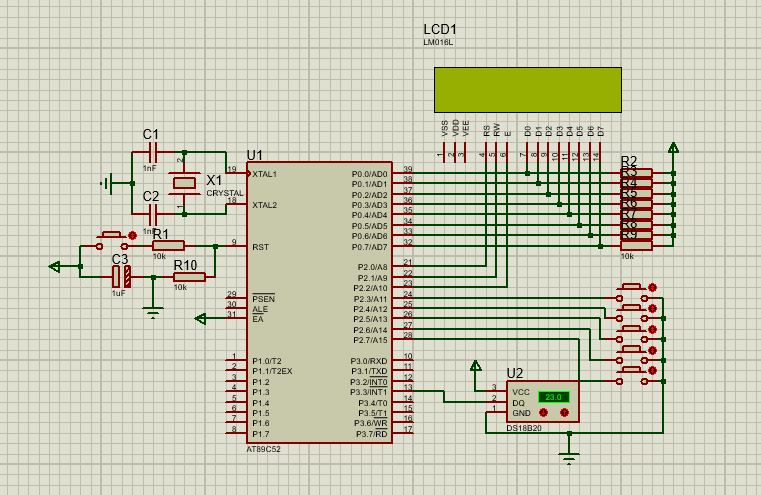

标题: 单片机万年历(带源程序) [打印本页]
作者: zwldd    时间: 2019-12-17 14:13
标题: 单片机万年历(带源程序)
#include<reg51.h>
#define uchar unsigned char
#define uint unsigned int
uchar code str1[]="2019-11-14 week4";
uchar code str2[]="23:59:55        ";
uchar code str3[]="0-22:00        ";
uchar code str4[]="0-23:00        ";
uchar c1=0,c2=0;//???? ?c1=1??c2=1?,?????
sbit RS=P2^0;
sbit RW=P2^1;
sbit E=P2^2;
bit s=0,d=1;// s???????,d=0???????
bit jia,jian;
uchar code string[]={0x0c,0xc7,0xc4,0xc1,0x89,0x86,0x83,0x8f,0x80,0x83,0x86,0xc0,0xc3,0xc6};//??????
uchar second=58,minute=59,hour=23,month=2,day=28,week=7,count=0;
uchar minute1=0,hour1=22,minute2=0,hour2=23;//??
uchar t_symbol; //??????,?1????,?0????
uint T;
unsigned int year=2019;    //0-65535
int m=0;
sbit key1=P2^3;//????
sbit key2=P2^4;//???
sbit key3=P2^5;//???
sbit key4=P2^6;//????
sbit key5=P2^7;//???
sbit beep=P1^0;//???
sbit DQ=P3^3;//????
