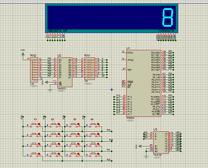

标题: 51单片机矩阵键盘数码管显示按键值Proteus仿真程序
  1. #include "reg51.h"
  2. #include "intrins.h"
  3. #define SEG7 P0
  4. #define Key P3
  5. unsigned char code DIG_CODE[17]={
  6. 0x3f,0x06,0x5b,0x4f,0x66,0x6d,0x7d,0x07,
  7. 0x7f,0x6f,0x77,0x7c,0x39,0x5e,0x79,0x71};
  8. void Delayms(unsigned int z);
  9. void Count(void);
  10. void DigtDisplay(void);
  11. void scan_key_f(void);
  12. void Scan_key_b(void);
  13. sbit LSA=P2^2;
  14. sbit LSB=P2^3;
  15. sbit LSC=P2^4;
  16. unsigned char Num;
  17. unsigned char Digt[8];
  18. void main()
  19. {
  20.         while(1)
  21.         {
  22.                 scan_key_f();
  23.                 Count();
  24.                 DigtDisplay();
  25.         }

  46. }
  47. void DigtDisplay()
  48. {
  49.                 unsigned char i;
  50.                 for(i=0;i<8;i++)
  51.                 {
  52.                         switch(i)
  53.                         {
  54.                                 case(0):
  55.                                         LSA=0;LSB=0;LSC=0; break;
  56.                                 case(1):
  57.                                         LSA=1;LSB=0;LSC=0; break;
  58.                                 case(2):
  59.                                         LSA=0;LSB=1;LSC=0; break;
  60.                                 case(3):
  61.                                         LSA=1;LSB=1;LSC=0; break;
  62.                                 case(4):
  63.                                         LSA=0;LSB=0;LSC=1; break;
  64.                                 case(5):
  65.                                         LSA=1;LSB=0;LSC=1; break;
  66.                                 case(6):
  67.                                         LSA=0;LSB=1;LSC=1; break;
  68.                                 case(7):
  69.                                         LSA=1;LSB=1;LSC=1; break;
  70.                         }
  71.                 SEG7=Digt[i];
  72.                 Delayms(2);
  73.           SEG7=0x00;  //清显示,消除重影
  74.         }
  75. }

  106. //}
  107. //
  108. //反转法 先行再列
  109. void scan_key_f()
  110. {
  111.         Key=0X0F;      //0000 1111
  112.         if(Key!=0X0F)
  113.         {
  114.                 Delayms(10);
  115.                 if(Key!=0X0F)
  116.                 {
  117.
  118.                         Key=0X0F;                 //判断行
  119.                         switch(Key)
  120.                         {
  121.                                 case 0x07: Num=1;break;                  //1  2 3  4
  122.                                 case 0x0B: Num=2;break;                 //5  6 7  8
  123.                                 case 0x0D: Num=3;break;                 //9 10 11 12
  124.                                 case 0x0E: Num=4;break;        //13 14 15 16
  125.                                 default: Num=0;break;
  126.                         }
  127.                 }
  128.                         Key=0XF0;    //判断列
  129.                         switch(Key)
  130.                         {
  131.                                 case 0xE0: Num=Num*4-3;break;
  132.                                 case 0xD0: Num=Num*4-2;break;
  133.                                 case 0xB0: Num=Num*4-1;break;
  134.                                 case 0x70: Num=Num*4;break;   //0111
  135.                                 default: Num=0;break;
  136.                         }
  137.
  138.                 while(Key!=0XF0);
  139.         }
  140. }
