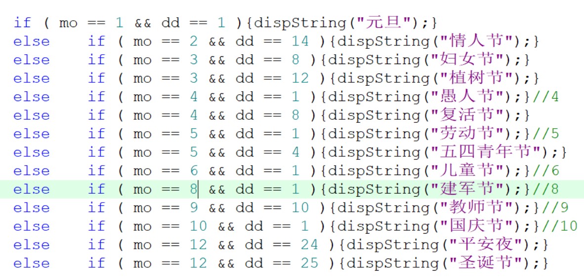

编译没有问题,但上位机没有显示,泪目了,,,,

void Fes_search(uint mo,uint dd)
        if ( mo == 1 && dd == 1 ){dispString("Ôaμ©");}
        else        if ( mo == 2 && dd == 14 ){dispString("Çéè˽ú");}
        else        if ( mo == 3 && dd == 8 ){dispString("¸¾Å®½ú");}
        else        if ( mo == 3 && dd == 12 ){dispString("Ö2ê÷½ú");}
        else        if ( mo == 4 && dd == 1 ){dispString("óTè˽ú");}//4
        else        if ( mo == 4 && dd == 8 ){dispString("¸′»î½ú");}
        else        if ( mo == 5 && dd == 1 ){dispString("àí¶ˉ½ú");}//5
        else        if ( mo == 5 && dd == 4 ){dispString("ÎåËÄÇàÄê½ú");}
        else        if ( mo == 6 && dd == 1 ){dispString("¶ùíˉ½ú");}//6
        else        if ( mo == 8 && dd == 1 ){dispString("½¨¾ü½ú");}//8
        else        if ( mo == 9 && dd == 10 ){dispString("½ìê|½ú");}//9
        else        if ( mo == 10 && dd == 1 ){dispString("1úÇì½ú");}//10
        else        if ( mo == 12 && dd == 24 ){dispString("ƽ°2ò1");}
        else        if ( mo == 12 && dd == 25 ){dispString("ê¥μ®½ú");}

作者: chenyiji    时间: 2020-12-6 23:54
嘶哥们是不是漏了波特率
