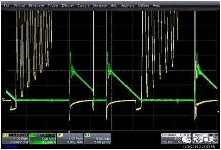

From the waveforms, it is found that at thetime of SSR turn off, its current is not zero but has a certain value, that is, at CCM mode.

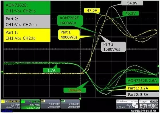

The waveforms of VDS and the current of SSR MOSFET are shown in Figure 3. The test condition is 230V AC input and 5V, 3A output. It could be found that the value of dv/dt is greatly relevant with EMI results. From the test result, there are two peak points near to the limit: one is about 50MHz,the other is 80-100MHz.

The capacitance characteristic of Coss of AON7262E is tuned inside to give a smoother switching performance, and help suppress the the EMI noise, besides the value of Coss. It has suitable value of dv/dt and optimum capacitance characteristics of Coss, as a result the circuit was able to pass all limits at whole frequency band width with enough margins. The voltage spike is also limited to acceptable level.
Figure 3: The waveforms of VDS and ID
