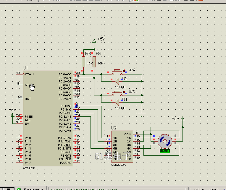

附件有全部内容
- #include "reg51.h"
- #define uchar unsigned char
- #define uint unsigned int
- #define out P2
- sbit pos=P0^0;
- sbit neg=P0^1;
- void delayms(uint);
- uchar code turn[]={0x02,0x06,0x04,0x0c,0x08,0x09,0x01,0x03};
- void main(void)
- uchar i;
- out=0x03;
- while(1)
- if(!pos)
- i = i < 8 ? i+1 : 0;
- out=turn[i];
- delayms(50);
- else if(!neg)
- i = i > 0 ? i-1 : 7;
- out=turn[i];
- delayms(50);
- void delayms(uint j)
- uchar i;
- for(;j>0;j--)
- i=250;
- while(--i);
- i=249;
- while(--i);
Proteus7.5版本的仿真dsn文件51hei附件下载:
不要用高版本的软件打开:
例12-1 步进电机控制.7z
