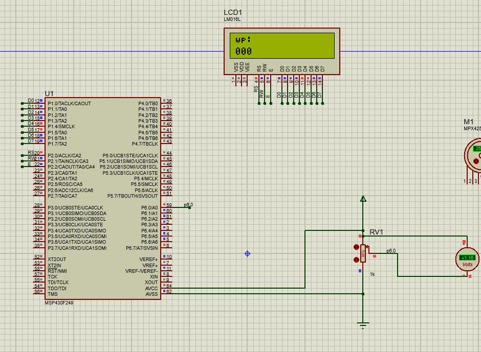

这个430单片机ad转换程序为什么lcd显示为000
10黑币
ad转换显示出问题,有无大佬帮看一下

ID:903700 发表于 2021-4-29 21:12 | 只看该作者
#include"msp430f249.h"
#include"string.h"
#define uchar unsigned char
#define uint unsigned int
const uchar table1[]="wp:";
unsigned char str[]={"0123456789"};
#define SET_RS P2OUT|=BIT0
#define RST_RS P2OUT&=~BIT0
#define SET_RW P2OUT|=BIT1
#define RST_RW P2OUT&=~BIT1
#define SET_E P2OUT|=BIT2
#define RST_E P2OUT&=~BIT2
long data;
unsigned char b;
void delayus(int ms)
  uint i,j;
  for(i=0;i<ms;i++)
    for(j=0;j<1141;j++);
void write_com(uchar com)
  RST_RS;
  RST_RW;
  P1OUT=com;
  SET_E;
  delayus(1);
  RST_E;
void write_dat(uchar dat)
  SET_RS;
  RST_RW;
  P1OUT=dat;
  SET_E;
  delayus(1);
  RST_E;
void disp(void)
  uchar i;
  WDTCTL=WDTPW+WDTHOLD;
  P1DIR=0xFF;
  P2DIR=BIT0+BIT1+BIT2;
  RST_E;
  write_com(0x38);
  delayus(5);
  write_com(0x01);
  delayus(5);
  write_com(0x0C);
  delayus(5);
  write_com(0x06);
  delayus(5);
  write_com(0x80);
  delayus(5);
  for(i=0;i<sizeof(table1);i++)
    write_dat(table1[i]);
  unsigned char t0=0,t1=0,t2=0;
  t0=data/100;
  t1=(data%100)/10;
  t2=data%10;
  write_com(0x80+0x40);
  delayus(5);
  write_dat(str[t0]);
  delayus(5);
  write_dat(str[t1]);
  delayus(5);
  write_dat(str[t2]);
void main(void)
  char k,m;
  volatile unsigned int i;
  m=10;
  P1DIR=0xFF;
  P2DIR=0XFF;
  P6SEL|=0X01;
  ADC12CTL0=ADC12ON;
  ADC12CTL1=SHP;
  ADC12MCTL0=SREF_1;
  for(i=0;i<0x3600;i++){}
  ADC12CTL0|=ENC;
    ADC12CTL0|=ADC12SC;
    while((ADC12IFG&BIT0)==0);
    k++;
    data=data+ADC12MEM0;
    if(k==m)
      data=data/m;
      data=data*50;
      data=data*10;
      data=data*10;
      data=data/4096;
    k=0;
    disp();
