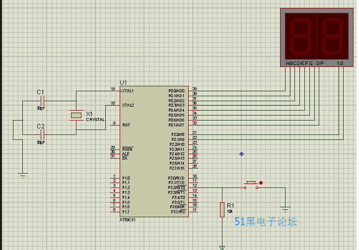

单片机按键计数器中断作业
查看数: 3790 | 评论数: 0 | 收藏 1
发布时间: 2017-12-4 09:25
#include<reg51.h> #define uchar unsigned char #define uint unsigned int uchar code segdate[]={0xc0,0xf9,0xa4,0xb0,0x99,0x92,0x82,0xf8,0x80,0x90}; uchar time; delay() {     ...
