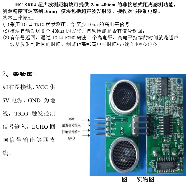

#include<reg52.h>         //距离超过150cm就报警 #define uchar unsigned char #define uint unsigned int sbit du=P2^6; sbit we=P2^7; sbit beep=P2^3; ...
ID:407566 发表于 2018-11-5 22:05
怎么接线?
