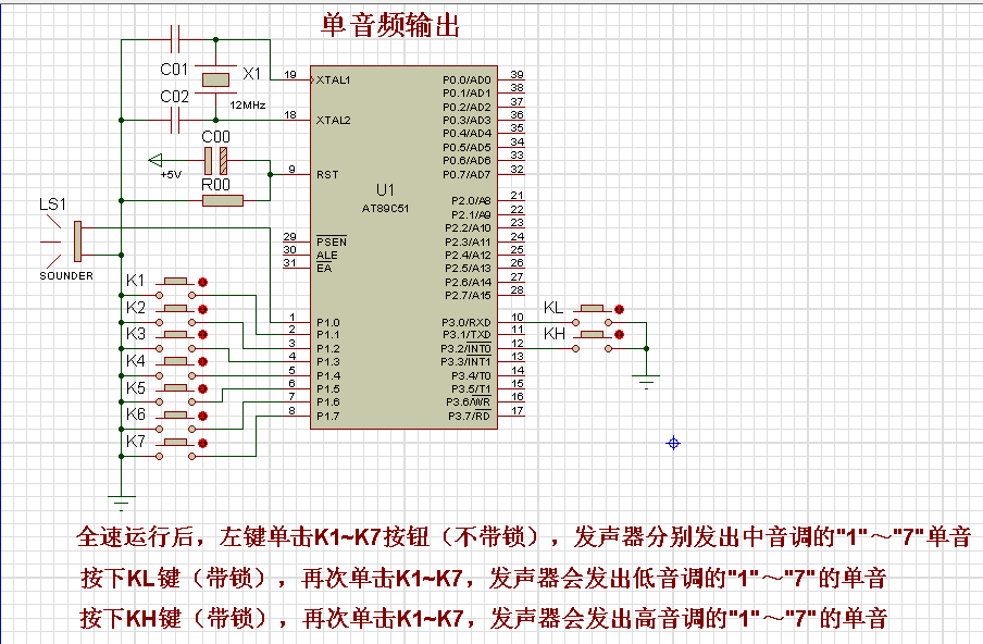

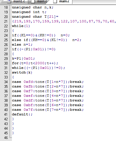

此例为单音频输出,想学习51的师兄可以先从此入手。 代码: #include<reg51.h> sbit SOND=P1^0; sbit KL=P3^0; sbit KH=P3^2; void tone(unsigned char t) { unsigned char j; unsigned int i; for(i= ...
