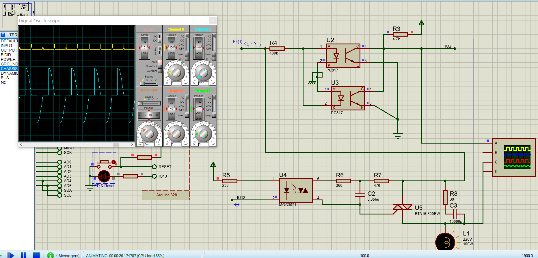

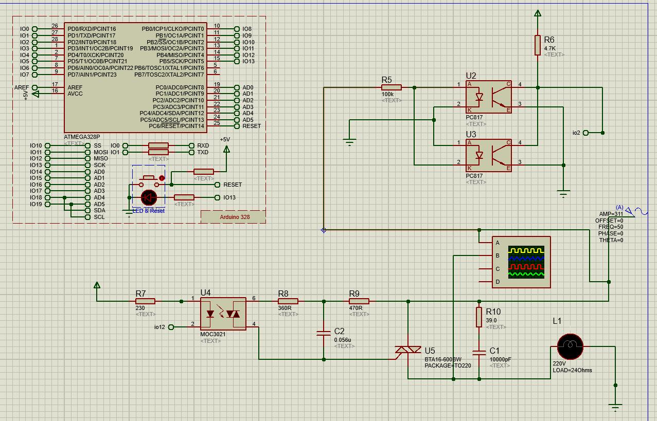

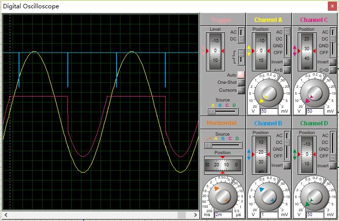

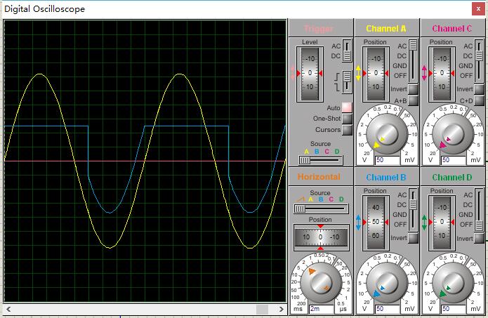

arduino+moc33021+bta16ΪʲôɶֻÓа벨¿ØÖÆ£¬Çó´óÀнâÒÉ
²é¿´Êý: 3287 | ÆÀÂÛÊý: 10 | ÊÕ²Ø 0
¹ØµÆ | Ìáʾ£ºÖ§³Ö¼üÅÌ·­Ò³<-×ó ÓÒ->
    ×éͼ´ò¿ªÖУ¬ÇëÉÔºò......
·¢²¼Ê±¼ä: 2019-11-1 17:54
ÕýÎÄÕªÒª:
void up() {   digitalWrite(12, HIGH);   delayMicroseconds(5000);   digitalWrite(12, LOW);   delayMicroseconds(1000);   digitalWrite(12, HIGH); ...

ÄãÓõÄÊÇÄĸö°æ±¾£¬ÎҸоõ¾ÍÊǰ汾²»¶Ôµ¼Öµġ£¡£¡£

ID:633947 ·¢±íÓÚ 2019-11-4 18:02
taotie ·¢±íÓÚ 2019-11-4 17:12
°´ÄãµÄ³ÌÐò·ÂÕæÃ»µÃÎÊÌâ¡£¡£
´óÀУ¬ÎÒ°Ñproteus8.7Ð¶ÔØÁËÖØÐÂ×°ÁËproteus8.9£¬ÏÖÔÚÄ£ÄâҲûÎÊÌâÁË¡£¡£¡£ºÜĪÃûÆäÃî°¡
ID:342822 ·¢±íÓÚ 2019-11-4 17:12

ID:342822 ·¢±íÓÚ 2019-11-4 10:51
¼ì²âµ½¹ýÁãºóÑÓʱ5ms¿ØÖÆmoc3021¿ªÍ¨£¿£¿£¿£¿
ÓÃ10msÊÔÒ»ÊÔ~~
ID:342822 ·¢±íÓÚ 2019-11-4 10:31
ÕâÊÇProteus 8 ÖеÄÀý³Ì¿´Ò»¿´°É
/* Main.ino file generated by New Project wizard
* Created:   mer ago 22 2018
* Processor: Arduino Uno
* Compiler:  Arduino AVR
int AC_LOAD = 3;    // Output to Opto Triac pin
int dimming = 128;  // Dimming level (0-128)  0 = ON, 128 = OFF
void setup()
  pinMode(AC_LOAD, OUTPUT);// Set AC Load pin as output
  attachInterrupt(0, zero_crosss_int, RISING);  // Choose the zero cross interrupt # from the table above
//the interrupt function must take no parameters and return nothing
void zero_crosss_int()  //function to be fired at the zero crossing to dim the light
  // Firing angle calculation : 1 full 50Hz wave =1/50=20ms
  // Every zerocrossing thus: (50Hz)-> 10ms (1/2 Cycle)
  // For 60Hz => 8.33ms (10.000/120)
  // 10ms=10000us
  // (10000us - 10us) / 128 = 75 (Approx) For 60Hz =>65
  int dimtime = (75*dimming);    // For 60Hz =>65
  delayMicroseconds(dimtime);    // Wait till firing the TRIAC
  digitalWrite(AC_LOAD, HIGH);   // Fire the TRIAC
  delayMicroseconds(10);         // triac On propogation delay (for 60Hz use 8.33)
  digitalWrite(AC_LOAD, LOW);    // No longer trigger the TRIAC (the next zero crossing will swith it off) TRIAC
void loop()  {
  for (int i=5; i <= 128; i++){
    dimming=i;
    delay(10);
