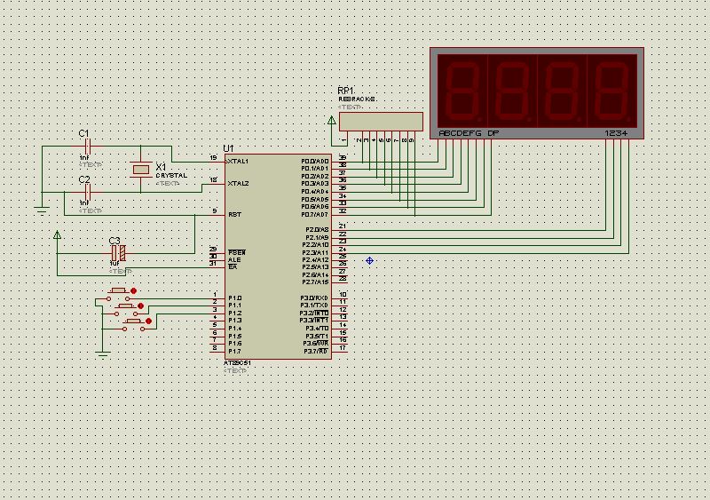

9999倒计时按键 单片机程序
查看数: 3182 | 评论数: 1 | 收藏 4
发布时间: 2019-12-10 15:25
#include #define uchar unsigned char #define uint unsigned int sbit k1 = P1^0;            //加 sbit k2 = P1^1;          ...
