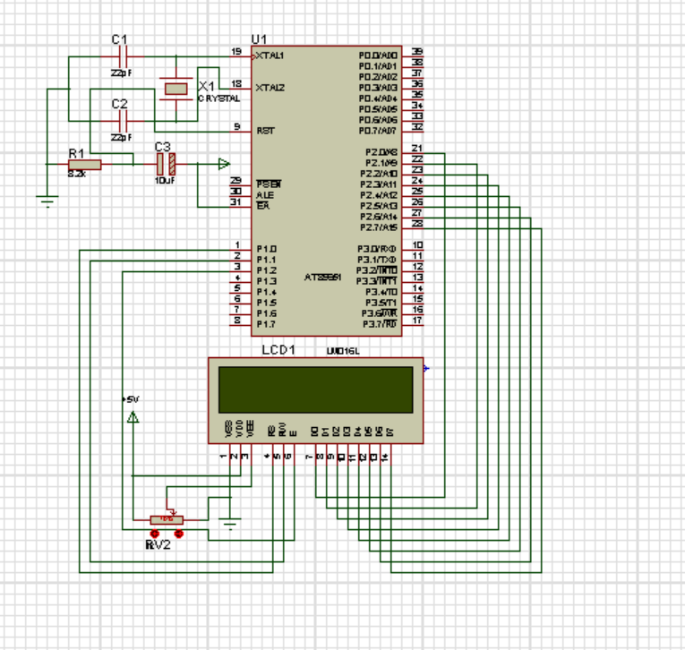

#include<reg52.h> #define LCD_DB  P0      sbit LCD_RS = P2^6; sbit LCD_RW = P2^5; sbit LCD_EN = P2^7; unsigned char Zh1[]="  Dian Zi 1801   ...
