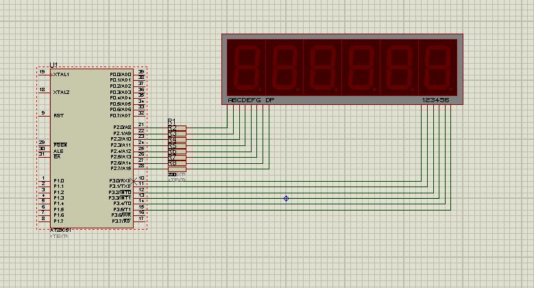

51单片机A-F动态数码管源程序
查看数: 1618 | 评论数: 0 | 收藏 0
发布时间: 2019-12-14 13:04
仿真程序: #include<reg51.h> #define uint unsigned int #define uchar unsigned char uchar code table[]={0x77,0x7c,0x39,0x5e,0x79,0x71}; uchar code table1[]={0x7c,0x39,0x5e,0x79,0x71 ...
