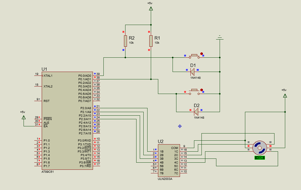

单片机步进电机控制程序
查看数: 1838 | 评论数: 0 | 收藏 0
发布时间: 2019-12-17 10:33
#include <reg51.h> #define uchar unsigned char #define uint unsigned int #define out P2 sbit pos=P0^0; sbit neg=P0^1; void delayms (uint); uchar code turn[]={0x02,0x06,0x04,0x0c,0x08,0x09,0 ...
