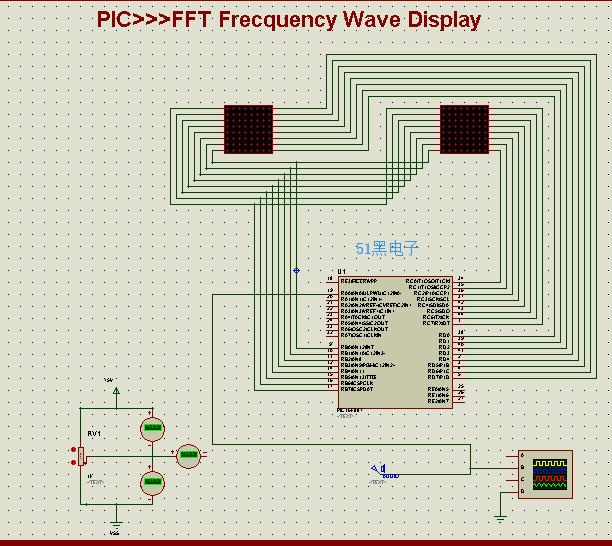

PIC单片机FFT音乐频谱Proteus仿真程序
查看数: 9537 | 评论数: 12 | 收藏 6
发布时间: 2020-1-3 11:50
因为贴子附件大小问题,wav音乐文件没有附上,请自行添加到目录,打开FFT.pdsprj文件,然后双击Audio图标指定音乐wav位置,开始运行即可,稍后再发下电脑里以前做的东东

  1. #include<STC12C5A60S2.H>
  2. typedef unsigned char uint8;
  3. typedef unsigned int  uint16;
  4. #define  channel  0x01                          //设置AD通道为 P1.0
  5. #define ADC_POWER   (1<<7)
  6. #define ADC_SPEEDHH (0x03<<5)
  7. #define ADC_START   (1<<3)
  8. #define PADCH       (1<<5)
  9. #define ADC_FLAG    (1<<4)
  10. #define P_3 P3 //32列扫描控制
  11. sbit sw=P1^2;//74HC154组切换控制位
  12. //放大128倍后的sin整数表(128)
  13. code char SIN_TAB[128]={0,6,12,18,24,30,36,42,48,54,59,65,70,75,80,85,89,94,98,102,
  14.                         105,108,112,114,117,119,121,123,124,125,126,126,126,126,126,
  15.                                                 125,124,123,121,119,117,114,112,108,105,102,98,94,89,85,80,75,
  16.                                                 70,65,59,54,48,42,36,30,24,18,12,6,0,-6,-12,-18,-24,-30,-36,-42,
  17.                                                 -48,-54,-59,-65,-70,-75,-80,-85,-89,-94,-98,-102,-105,-108,-112,
  18.                                                 -114,-117,-119,-121,-123,-124,-125,-126,-126,-126,-126,-126,-125,
  19.                                                 -124,-123,-121,-119,-117,-114,-112,-108,-105,-102,-98,-94,-89,-85,
  20.                                                 -80,-75,-70,-65,-59,-54,-48,-42,-36,-30,-24,-18,-12,-6};
  21. //放大128倍后的cos整数表(128)
  22. code char COS_TAB[128]={127,126,126,125,124,123,121,119,117,114,112,108,105,102,98,94,
  23.                         89,85,80,75,70,65,59,54,48,42,36,30,24,18,12,6,0,-6,-12,-18,-24,
  24.                                                 -30,-36,-42,-48,-54,-59,-65,-70,-75,-80,-85,-89,-94,-98,-102,
  25.                                                 -105,-108,-112,-114,-117,-119,-121,-123,-124,-125,-126,-126,-126,
  26.                                                 -126,-126,-125,-124,-123,-121,-119,-117,-114,-112,-108,-105,-102,
  27.                                                 -98,-94,-89,-85,-80,-75,-70,-65,-59,-54,-48,-42,-36,-30,-24,-18,
  28.                                                 -12,-6,0,6,12,18,24,30,36,42,48,54,59,65,70,75,80,85,89,94,98,102,
  29.                                                 105,108,112,114,117,119,121,123,124,125,126,126};
  30. //采样存储序列表
  31. code char LIST_TAB[128] = {0,64,32,96,16,80,48,112,8,72,40,104,24,88,56,120,4,68,36,100,20,84,52,116,
  32.                            12,76,44,108,28,92,60,124,2,66,34,98,18,82,50,114,10,74,42,106,26,90,58,
  33.                                                    122,6,70,38,102,22,86,54,118,14,78,46,110,30,94,62,126,1,65,33,97,17,81,49,
  34.                                                    113,9,73,41,105,25,89,57,121,5,69,37,101,21,85,53,117,13,77,45,109,29,93,61,
  35.                                                    125,3,67,35,99,19,83,51,115,11,75,43,107,27,91,59,123,7,71,39,103,23,87,55,
  36.                                                    119,15,79,47,111,31,95,63,127};
  37. uint8 LED[32]={0x80,0x00,0xC0,0x00,0xE0,0x00,0xF0,0x00,
  38.                0xF8,0x00,0xFC,0x00,0xFE,0x00,0xFF,0x00,
  39.                0xff,0x80,0xff,0xC0,0xff,0xE0,0xff,0xF0,
  40.                            0xff,0xF8,0xff,0xFC,0xff,0xFE,0xff,0xFF,};
  41. uint8 COUNT=15,COUNT1=0,ADC_Count=0,LINE=15,G=0,T;

  52. {
  53.     for( i=1; i<=7; i++)                            /* for(1) */
  54.     {
  55.         b=1;
  56.         b <<=(i-1);                                 //碟式运算,用于计算隔多少行计算例如 第一极 1和2行计算
  57.         for( j=0; j<=b-1; j++)                      /* for (2) */
  58.         {
  59.             p=1;
  60.             p <<= (7-i);
  61.             p = p*j;
  62.             for( k=j; k<128; k=k+2*b)               /* for (3)  */
  63.             {
  64.                 Temp_Real=Fft_Real[k];
  65.                                 Temp_Imag=Fft_Image[k];
  66.                                 temp=Fft_Real[k+b];
  67.                 Fft_Real[k]=Fft_Real[k]+((Fft_Real[k+b]*COS_TAB[p])>>7)+((Fft_Image[k+b]*SIN_TAB[p])>>7);
  68.                 Fft_Image[k]=Fft_Image[k]-((Fft_Real[k+b]*SIN_TAB[p])>>7)+((Fft_Image[k+b]*COS_TAB[p])>>7);
  69.                 Fft_Real[k+b]=Temp_Real-((Fft_Real[k+b]*COS_TAB[p])>>7)-((Fft_Image[k+b]*SIN_TAB[p])>>7);
  70.                 Fft_Image[k+b]=Temp_Imag+((temp*SIN_TAB[p])>>7)-((Fft_Image[k+b]*COS_TAB[p])>>7);          // 移位.防止溢出. 结果已经是本值的 1/64
  71.                 Fft_Real[k] >>= 1;
  72.                 Fft_Image[k] >>= 1;
  73.                 Fft_Real[k+b] >>= 1;
  74.                 Fft_Image[k+b] >>= 1;
  75.
  76.             }
  77.         }
  78.     }
  79.         for(j=0;j<16;j++)//16分频
  80.         {
  81.                 TEMP1=((((Fft_Real[j+1]* Fft_Real[j+1]))+((Fft_Image[j+1]*Fft_Image[j+1])))>>1);//求各频段幅值
  82.                 if(TEMP1<1)TEMP1=0;
  83.                 LED_TAB[j]=TEMP1;
  84.                 if(LED_TAB[j]>max)max=LED_TAB[j];
  85.         }
  86.         if(max>16)//分级量化
  87.         {
  88.           max/=16;
  89.           for(j=0;j<16;j++)LED_TAB[j]/=max;
  90.         }
  91. }
