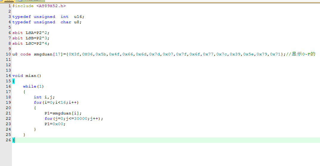

快崩溃了compiling led.c... linking... *** WARNING L16: UNCALLED SEGMENT, IGNO...

#include <AT89X52.h> typedef unsigned  int  u16; typedef unsigned  char u8; sbit LSA=P2^2; sbit LSB=P2^3; sbit LSC=P2^4; u8 code smgduan[17]={0X3f,0X06,0x5b,0 ...

你太粗心了,程序没有主程序,把mian()改成main()吧
