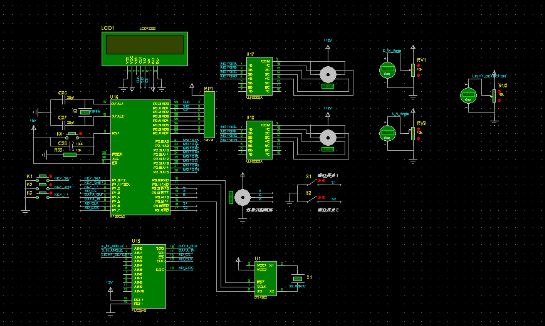

求助,根据ds1302得出的时间进行太阳追踪 单片机程序问题
查看数: 2925 | 评论数: 7 | 收藏 0
发布时间: 2020-4-6 12:33
我想根据制作一个可以调节的ds1302时钟,再根据时钟计算出太阳高度角和方位角来进行太阳追踪 可是我的程序却不能用按键将改好的时间写入ds1302 有高手能看下哪里不正确需要改吗 单片机源程序如下: #inc ...

这是算太阳角度,和主程序,望大佬指正
  1. /*计算太阳角度*/
  2. void anglecalculate()
  3. {
  4.    int     leap;
  5.    uint    year,mon,day;
  6.    uint    hour,min,sec;
  7.    uint    DayAdd;
  8.    uchar   DecAngle,HourAngle,DecAngle1;
  9.    uchar   EleAngle,AziAngle,AziAngle1;
  10.    year=(time[6]>>4)*10+(time[6]&0x0f)+2000;
  11.    mon=(time[4]>>4)*10+(time[4]&0x0f);
  12.    day=(time[3]>>4)*10+(time[3]&0x0f);
  13.    hour=(time[2]>>4)*10+(time[2]&0x0f);
  14.    min=(time[1]>>4)*10+(time[1]&0x0f);
  15.    sec=(time[0]>>4)*10+(time[0]&0x0f);
  16.    leap=(year%4==0&&year%100!=0)||(year%400==0);闰年计算
  17.    switch(mon)
  18.           {
  19.             case 1:
  20.                   DayAdd=(day);break;
  21.             case 2:
  22.                   DayAdd=31+day;break;
  23.             case 3:
  24.                           DayAdd=31+28+day;break;
  25.             case 4:
  26.                           DayAdd=31+28+31+day;break;
  27.             case 5:
  28.                           DayAdd=31+28+31+30+day;break;
  29.             case 6:
  30.                           DayAdd=31+28+31+30+31+day;break;
  31.             case 7:
  32.                           DayAdd=31+28+31+30+31+30+day;break;
  33.             case 8:
  34.                       DayAdd=31+28+31+30+31+30+31+day;break;
  35.             case 9:
  36.                           DayAdd=31+28+31+30+31+30+31+31+day;break;
  37.             case 10:
  38.                           DayAdd=31+28+31+30+31+30+31+31+30+day;break;
  39.             case 11:
  40.                           DayAdd=31+28+31+30+31+30+31+31+30+31+day;break;
  41.             case 12:
  42.                           DayAdd=31+28+31+30+31+30+31+31+30+31+30+day;break;
  43.                 default:
  44.                       break;         /*cout<<"月份输入错误!*/
  45.           }
  46.   if(leap&&(mon>=3))
  47.   DayAdd=DayAdd+1; //当前天数
  48.   DecAngle=(23.45*sin(2*PI*(284+DayAdd)/365))*PI/180;//计算赤纬角
  49.   DecAngle1=(23.45*sin(2*PI*(284+DayAdd+1)/365))*PI/180;//计算第二天赤纬角
  50.   HourAngle=(12-(hour)-(min)/60.0-(sec)/3600.0)*PI/12;//计算时角
  51.   EleAngle=asin(sin(LAT)*sin(DecAngle)+cos(LAT )*cos(DecAngle)*cos(HourAngle));//计算高度角
  52.   AziAngle=acos((sin(EleAngle)*sin(LAT )-sin(DecAngle))/(cos(EleAngle)*cos(LAT )));//计算方位角
  53.   AziAngle1=acos((0-sin(DecAngle1))/cos(LAT ));//计算第二天的方位角
  54.   angle[0]=EleAngle;
  55.   angle[1]=AziAngle;
  56.   angle[2]=AziAngle1;
  57.
  58.
  59. }/*视日轨迹追踪*/
  60. void trackgo()
  61. {
  62.     uchar h,f;
  63.     uchar y,z;
  64.     uchar p,q;
  65.     uchar c=0,d=0;
  66.
  67.     h=angle[0];//得到高度角
  68.     f=angle[1];//得到方位角
  69.     y=(f-c)/5;//计算方位电机需旋转圈数
  70.     z=(h-d)/1;//计算高度电机需旋转圈数
  71.     c=f;
  72.     d=h;
  73.     if(y!=0)
  74.     {
  75.       for(p=0;p<y;p++)
  76.        {
  77.         GoA1();
  78.        }
  79.      }
  80.     else
  81.      {
  82.        if(z!=0)
  83.         {
  84.          for(q=0;q<z;q++)
  85.           {
  86.             GoB1();
  87.            }
  88.          }
  89.       }
  90.     P2=0x00;
  91. }
  92. //函数:void main()功能:主函数,初始化
  93. void main()
  94. {
  95.     uchar psec=0xaa;
  96.     uchar time_30s=0;
  97.     uint getdata;
  98.     float temp;
  99.
  100.     P2=0x00;
  101.         time_500ms = 0;
  102.         flag_js = 0;
  103.         count1 = 1;
  104.         count2 = 1;
  105.     InitDS1302();
  106.     timer_init();
  107.     Out_Init();
  108.    LCD_init();
  109.
  110.     delay_ms(50);
  111.     E_W_ANGLE=read2543(0x00);
  112.     S_N_ANGLE=read2543(0x10);
  113.     LIGHT_DETECTION=read2543(0x20);
  114.
  115.         while(1)
  116.         {
  117.
  118.        if(time_500ms == 50)
  119.        {
  120.             time_500ms=0;
  121.             DS1302BurstRead(time);//获得时间
  122.             key();
  123.             anglecalculate();
  124.             if(psec!=time[0])
  125.              {
  126.                            disp(flag_js); //用液晶显示时间
  127.                psec=time[0];
  128.               }
  129.             time_30s++;
  130.
  131.             if(time_30s==6)//3s判定一次方位
  132.              {
  133.                  time_30s=0;
  134.                  getdata=read2543(0x20);
  135.                  getdata=read2543(0x20);
  136.                  getdata=read2543(0x20);
  137.                  temp=(float)getdata/4095*500;
  138.                  LIGHT_DETECTION=temp;//当前光照强度
  139.                  temp=0;
  140.                  if(LIGHT_DETECTION<300&&LIGHT_DETECTION>100)//光强不足启用视日轨迹追踪
  141.                   {
  142.                      trackgo();
  143.                    }
  144.             }
  145.
  146.             startgo();
  147.        }
  148.         }
  149. }
