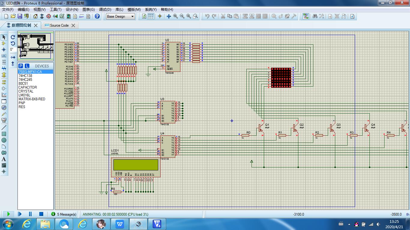

单片机小白求大神指教   在做LED点阵仿真的时候有没有出现列亮正常,一旦牵扯到行亮就有异常的情况?有解决办法吗?(如下所示) 图1  让第三列亮   显示正常 ;图2、3 分别是让第一 ...
ID:704483 发表于 2020-4-21 14:38
很抱歉发成这个样子。上面大图第一张是图三  第二张是图二 第三张是图一  第四张大图和三张小图都没用
图一代码是这样的,#include<reg52.h>
sbit ADDR0 = P1^0;
sbit ADDR1 = P1^1;
sbit ADDR2 = P1^2;
sbit ADDR3 = P1^3;
sbit ENLED = P1^4;
unsigned char code image[]={
0xFB,0xFB,0xFB,0xFB,0xFB,0xFB,0xFB,0xFB    //点阵取模  字节倒序
void main()
         EA=1;
         ENLED = 0;
         ADDR3 = 0;
         TMOD  = 0x10;
         TH1 = 0xFC;
     TL1 = 0x67;
         ET1= 1;
         TR1 = 1;
     while(1);
void InterrumptTimer1()  interrupt 3
         static unsigned char i=0;
         TH1=0xFC;
         TL1=0x67;
         P0 =0xFF;
         switch(i)
             case 0: ADDR2=0; ADDR1=0; ADDR0=0; i++; P0=image[0];break;
                 case 1: ADDR2=0; ADDR1=0; ADDR0=1; i++; P0=image[1];break;
                 case 2: ADDR2=0; ADDR1=1; ADDR0=0; i++; P0=image[2];break;
                 case 3: ADDR2=0; ADDR1=1; ADDR0=1; i++; P0=image[3];break;
                 case 4: ADDR2=1; ADDR1=0; ADDR0=0; i++; P0=image[4];break;
                 case 5: ADDR2=1; ADDR1=0; ADDR0=1; i++; P0=image[5];break;
                 case 6: ADDR2=1; ADDR1=1; ADDR0=0; i++; P0=image[6];break;
                 case 7: ADDR2=1; ADDR1=1; ADDR0=1; i=0; P0=image[7];break;
                 default:break;
