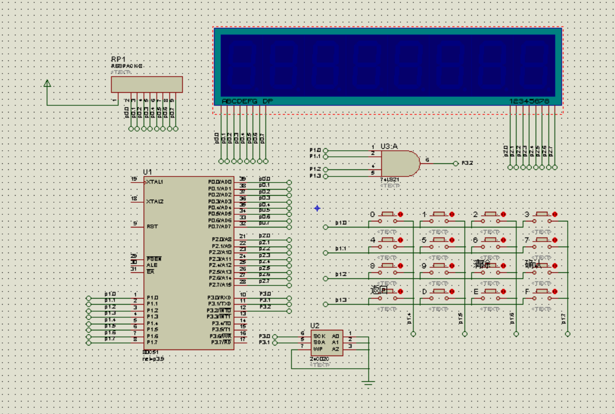

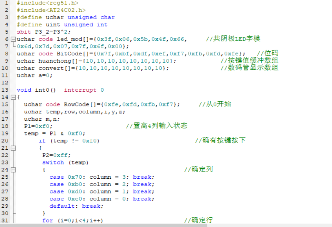

代码怎么修改可以实现图上的内容  有AT24C02的头文件
ID:768342 发表于 2020-6-3 13:15
#include<reg51.h>
#include<AT24C02.h>
#define uchar unsigned char
#define        uint unsigned int
sbit P3_2=P3^2;
uchar code led_mod[]={0x3f,0x06,0x5b,0x4f,0x66,
0x6d,0x7d,0x07,0x7f,0x6f,0x00};
uchar code BitCode[]={0x7f,0xbf,0xdf,0xef,0xf7,0xfb,0xfd,0xfe};
uchar huanchong[]={10,10,10,10,10,10,10,10};
uchar convert[]={10,10,10,10,10,10,10,10};
uchar a=0;
void int0()  interrupt 0
        uchar code RowCode[]={0xfe,0xfd,0xfb,0xf7};
        uchar temp,row,column,i,y,z;
        uchar m,n;
        P1=0xf0;
        temp = P1 & 0xf0;
            if (temp != 0xf0)
       P2=0xff;
       switch (temp)
                                 case 0x70: column = 3; break;
                                 case 0xb0: column = 2; break;
                                 case 0xd0: column = 1; break;
                                 case 0xe0: column = 0; break;
                                 default: break;
                         for (i=0;i<4;i++)
                                 P1 = RowCode[i];
                                 temp = P1 & 0xf0;
                                 if (temp !=0xf0)
                                         row = i;break;
                         y= row *4 + column;
                         if(y<10)
                                 if(a<8)
                                         huanchong[a++]=y;
                             m=a;
                                         for(n=0;n<a;n++)
                                convert[n]=huanchong[--m];
             if(y>=10)
                                 P2=0xff;
                                 a=0;
                                 for(z=0;z<8;z++)
                                         huanchong[z]=10;
                                         convert[z]=10;
                        while((P1 & 0xf0) !=0xf0);
void BufToSeg(void)
        uchar i=0;
        for(;i<8;i++)
                P0=led_mod[10];
                P2= BitCode[i];
                P0=led_mod[convert[i]];
void main(void)
        EA=1;
        EX0=1;
        IT0=1;
                P1=0x0f;
                BufToSeg();
