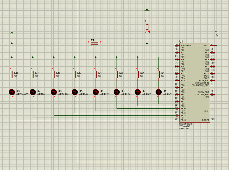

STM32无法循环点亮,求个大神帮帮忙

#include "stm32f10x.h" uint16_t temp,i; void Delay(unsigned int count) {         unsigned int i;         for(;count!=0;count--) &n ...

是IPU(上拉输入),而IPD是(下拉),很明显PA0接了个电阻到VDD,而当有按键按下时,电路接通到地,所以PA0处读到的电压是0,当释放时,与VDD想接,是高电平为1
ID:277948 发表于 2020-6-21 18:19
我把程序改为 按键按下灯取反四次

        GPIO_InitStructure.GPIO_Mode = GPIO_Mode_IPD;//注意GPIO_Mode_IPD不是GPIO_Mode_IPU

                                temp=0x0001;//注要放在循环前边
        if(GPIO_ReadInputDataBit(GPIOA,GPIO_Pin_0)==1)     //没按下按键为0 按下按键为1

   }while(GPIO_ReadInputDataBit(GPIOA,GPIO_Pin_0)==0); //按键释放应该放在按键判断之外
