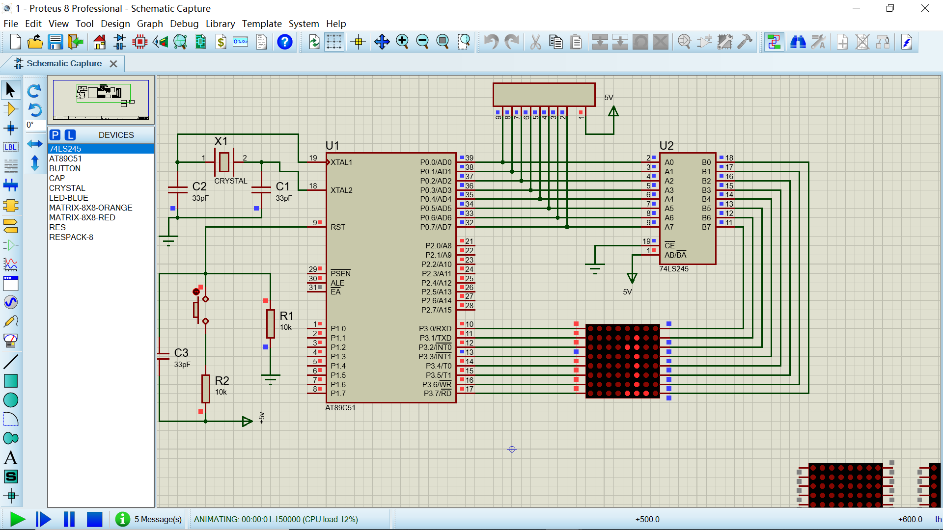

单片机点阵显示实验
查看数: 1764 | 评论数: 0 | 收藏 0
发布时间: 2021-1-10 13:49
点阵显示实验 #include <reg51.h>         unsigned char code tab[]={0xfe,0xfd,0xfb,0xf7,0xef,0xdf,0xbf,0x7f};         unsigned char ...
