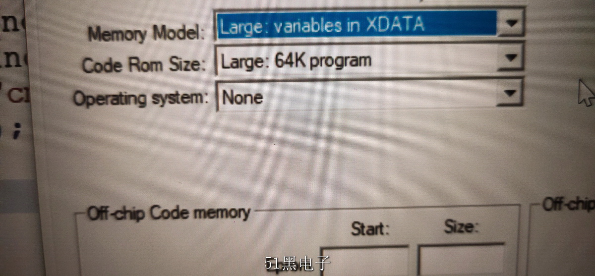

stc89s52和stc89C55rd+程序能通用吗?52内部8krom不够用了,求问大神

ID:161164 发表于 2022-2-11 23:12
易游 发表于 2022-2-11 21:33
改成large单片机只走部分程序
STC89C52:Code:8k Ram:512(128data+128idata+256xdata)
STC89C55:Code:20k Ram:1280(128data+128idata+1024xdata)
Memory Model只能选Small
然后在定义变数时要加上idata 或 xdata 如:
char xdata StrBuffy[] = {"y0123456789abcdefghijklmnopqrstuvwxyzABCDEFGHIJKLMNOPQRSTUVWXYZ\r\n"};
char idata StrBuff2[] = {"0123456789abcdefghijklmnopqrstuvwxyzABCDEFGHIJKLMNOPQRSTUVWXYZ\r\n"};
