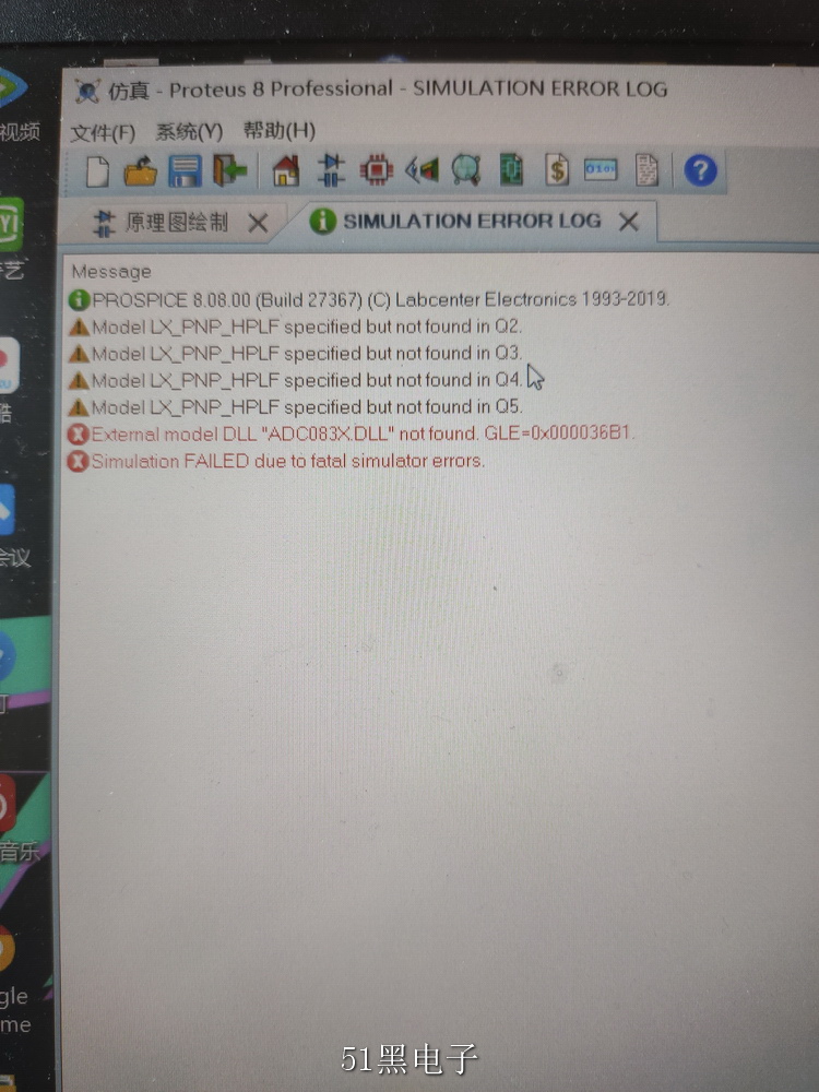

External model DLL “ADC083X.DLL“ not found. GLE=0x000036B1这是什么原因

Proteus仿真报错External model DLL “ADC083X.DLL“ not found. GLE=0x000036B1
ID:1050554 发表于 2022-11-6 17:27
用Proteus7.10中的models库替换
