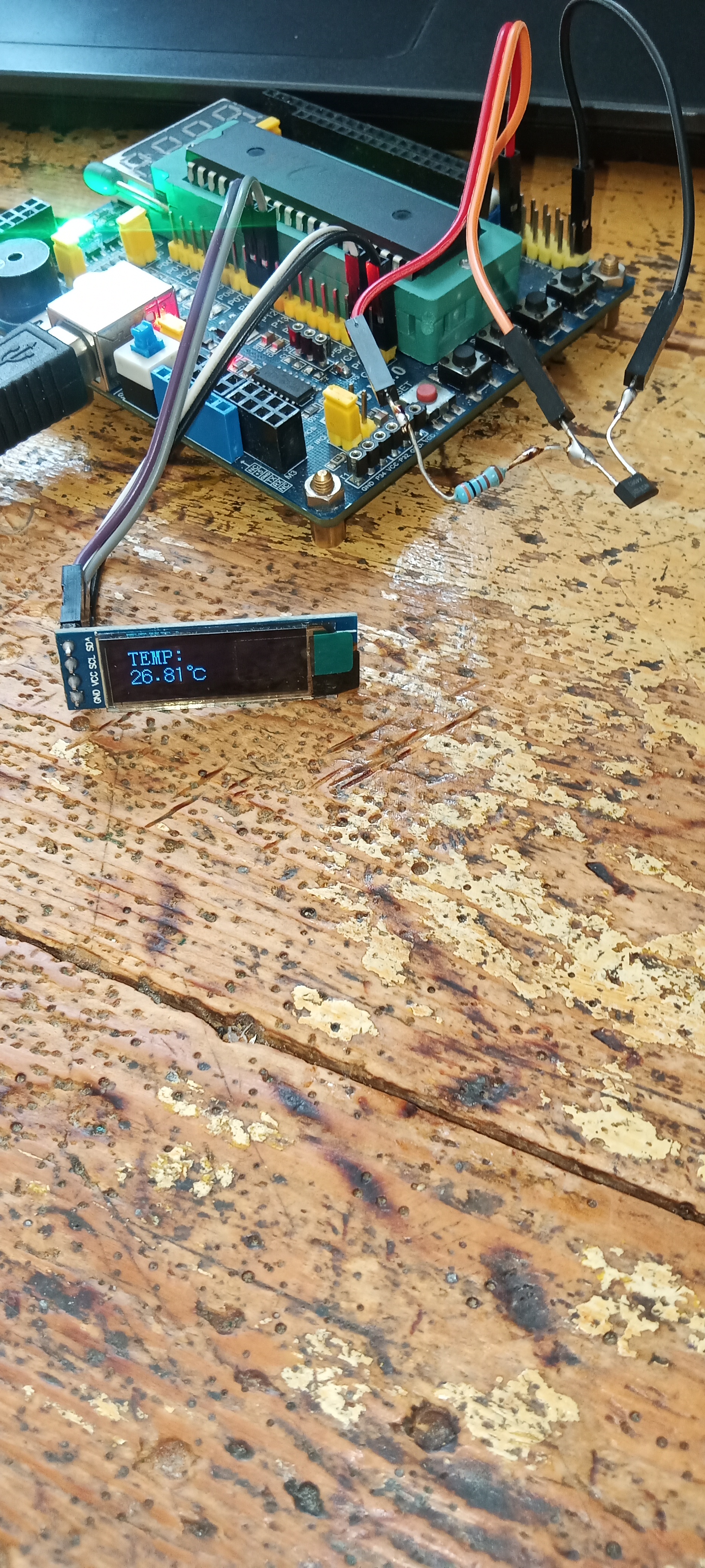

使用NST1001数字脉冲输出型温度传感器实验
查看数: 854 | 评论数: 2 | 收藏 0
发布时间: 2026-3-30 13:40
在一定周期内对传感器输出的脉冲计数,计算成温度值。通过0.91寸的12832 OLED显示并用串口发送。非常好用
ID:71233 发表于 2026-4-3 12:00
NST1001用过,它需要一个定时器作为计数器对一定周期内进行脉冲计数?
ID:1136941 发表于 2026-3-30 13:47
  1. #include "STC8H.H"

  104. 0x00,0x00,0x00,0x00,0x00,0x0F,0x10,0x20,0x20,0x20,0x20,0x20,0x10,0x08,0x00,0x00,
  105. /*  "%"  16X16   -815-*/
  106. 0x00,0x00,0x38,0x44,0x44,0x44,0x38,0x00,0x80,0x40,0x20,0x10,0x08,0x00,0x00,0x00,

  154.   P1M0 = 0x00;
  155.         P1M1 = 0x00;
  156.         P2M0 = 0x00;
  157.         P2M1 = 0x00;
  158.         P3M0 = 0x00;
  159.         P3M1 = 0x00;
  160. }
  161. void Timer0_Isr(void) interrupt 1 //35ms采集周期
  162. {
  163.         EX0=0;    //关闭外中断0
  164.         TR0=0;    //关闭定时器0
  165.         dat=count;//转存计数值
  166.         count=0;
  167.         EX0=1;    //开外中断0
  168. }
  169. void int0_isr()interrupt 0
  170. {
  171.         if(DQ==0)
  172.         {
  173.           count++;
  174.           TR0=1;
  175.         }
  176. }

  234.     }
  235.       SDA=1;
  236.       delay1us();
  237.       SCL=1;
  238.       delay1us();
  239.       SCL=0;
  240. }
  241. void Write_i2c_Cmd(uint8_t i2c_Cmd)
  242. {
  243.    i2c_Start();
  244.    Write_i2c_Byte(0x78);
  245.    Write_i2c_Byte(0x00);
  246.    Write_i2c_Byte(i2c_Cmd);
  247.    i2c_Stop();
  248. }
  249. void Write_i2c_Data(uint8_t i2c_Data)
  250. {
  251.    i2c_Start();
  252.    Write_i2c_Byte(0x78);
  253.    Write_i2c_Byte(0x40);
  254.    Write_i2c_Byte(i2c_Data);
  255.    i2c_Stop();
  256. }
  257. void Init_ssd1306_32()
  258. {
  259.     Write_i2c_Cmd(0xAE);
  260.     Write_i2c_Cmd(0x20);
  261.     Write_i2c_Cmd(0x00);
  262.     Write_i2c_Cmd(0xb0);
  263.     Write_i2c_Cmd(0xc8);
  264.     Write_i2c_Cmd(0x00);
  265.     Write_i2c_Cmd(0x10);
  266.     Write_i2c_Cmd(0x40);
  267.     Write_i2c_Cmd(0x81);
  268.     Write_i2c_Cmd(0xdf);
  269.     Write_i2c_Cmd(0xa1);
  270.     Write_i2c_Cmd(0xa6);
  271.     Write_i2c_Cmd(0xa8);
  272.     Write_i2c_Cmd(0x1F);
  273.     Write_i2c_Cmd(0xa4);
  274.     Write_i2c_Cmd(0xd3);
  275.     Write_i2c_Cmd(0x00);
  276.     Write_i2c_Cmd(0xd5);
  277.     Write_i2c_Cmd(0xf0);
  278.     Write_i2c_Cmd(0xd9);
  279.     Write_i2c_Cmd(0x22);
  280.     Write_i2c_Cmd(0xda);
  281.     Write_i2c_Cmd(0x12);
  282.     Write_i2c_Cmd(0xdb);
  283.     Write_i2c_Cmd(0x20);
  284.     Write_i2c_Cmd(0x8d);
  285.     Write_i2c_Cmd(0x14);
  286.     Write_i2c_Cmd(0xDA);
  287.     Write_i2c_Cmd(0x02);
  288.     Write_i2c_Cmd(0xaf);
  289. }
  290. void Clear_top()
  291. {
  292.      uint16_t i;
  293.      Write_i2c_Cmd(0x22);
  294.      Write_i2c_Cmd(0xb0);
  295.      Write_i2c_Cmd(0xb1);
  296.      Write_i2c_Cmd(0x21);
  297.      Write_i2c_Cmd(0);
  298.      Write_i2c_Cmd(127);
  299.      for(i=0;i<512;i++) Write_i2c_Data(0x00);
  300. }
  301. void Clear_buttom()
  302. {
  303.       uint16_t i;
  304.       Write_i2c_Cmd(0x22);
  305.       Write_i2c_Cmd(0xb2);
  306.       Write_i2c_Cmd(0xb3);
  307.       Write_i2c_Cmd(0x21);
  308.       Write_i2c_Cmd(0);
  309.       Write_i2c_Cmd(127);
  310.       for(i=0;i<512;i++) Write_i2c_Data(0x00);
  311. }
  312. void Write_8X16(uint8_t c0,uint8_t aa,uint16_t add)
  313. {
  314.       uint8_t m;
  315.       Write_i2c_Cmd(0x22);
  316.       Write_i2c_Cmd(c0);
  317.       Write_i2c_Cmd(c0+1);
  318.       Write_i2c_Cmd(0x21);
  319.       Write_i2c_Cmd(aa);
  320.       Write_i2c_Cmd(aa+7);
  321.       for(m=0;m<16;m++) Write_i2c_Data(zk[add++]);
  322. }
  323. void Write_16X16(uint8_t c0,uint8_t aa,uint16_t add)
  324. {
  325.       uint8_t m;
  326.       Write_i2c_Cmd(0x22);
  327.       Write_i2c_Cmd(c0);
  328.       Write_i2c_Cmd(c0+1);
  329.       Write_i2c_Cmd(0x21);
  330.       Write_i2c_Cmd(aa);
  331.       Write_i2c_Cmd(aa+15);
  332.       for(m=0;m<32;m++) Write_i2c_Data(zk[add++]);
  333. }
  334. //*******************************//
  335. void main()
  336. {
  337.         float wendu;
  338.         unsigned int temp;
  339.         unsigned char i;
  340.
  341.         chushihua();
  342.         Init_ssd1306_32();
  343.   Clear_top();
  344.   Clear_buttom();
  345.
  346.   Write_8X16(0xb0,8,511);//T温度
  347.   Write_8X16(0xb0,16,271);//E
  348.   Write_8X16(0xb0,24,399);//M
  349.   Write_8X16(0xb0,32,447);//P
  350.   Write_8X16(0xb0,40,175);//:
  351.
  352.         while(1)
  353.         {
  354.                 if(dat>=801)//正温度/801对应0度
  355.                 {
  356.                         wendu=(dat-801)*0.0625;
  357.                 }
  358.                 else        //负温度/801对应0度
  359.                 {
  360.                         wendu=(801-dat)*0.0625;
  361.                 }
  362.                 temp=wendu*100;//扩大100倍
  363.
  364.                 sendBuf[0]=temp/10000%10;
  365.                 sendBuf[1]=temp/1000%10;
  366.                 sendBuf[2]=temp/100%10;
  367.                 sendBuf[3]=temp/10%10;
  368.                 sendBuf[4]=temp%10;
  369.
  370.                 Delay1000ms();
  371.     P35=~P35;
  372.
  373.                 for(i=0;i<5;i++)
  374.                 {
  375.                         SBUF=sendBuf[i];//串口发送
  376.                         while(TI==0);
  377.                         TI=0;
  378.                 }
  379.                 if(sendBuf[0]>0)
  380.                 {
  381.                  Write_8X16(0xb2,0*8,sendBuf[0]*16);
  382.                 }
  383.                 else
  384.                 {
  385.                  Write_8X16(0xb2,0*8,847);//显示" "消零
  386.                 }
  387.                  Write_8X16(0xb2,1*8,sendBuf[1]*16);
