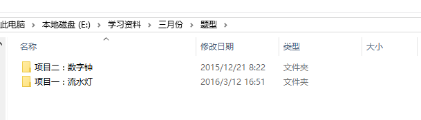

期末老师考试前发的资料包给复习

有几个项目?

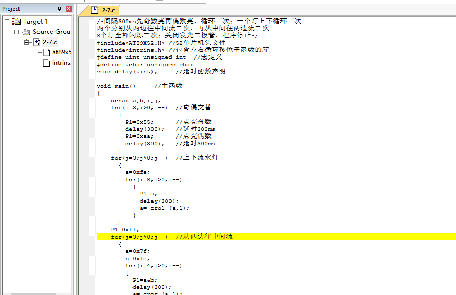

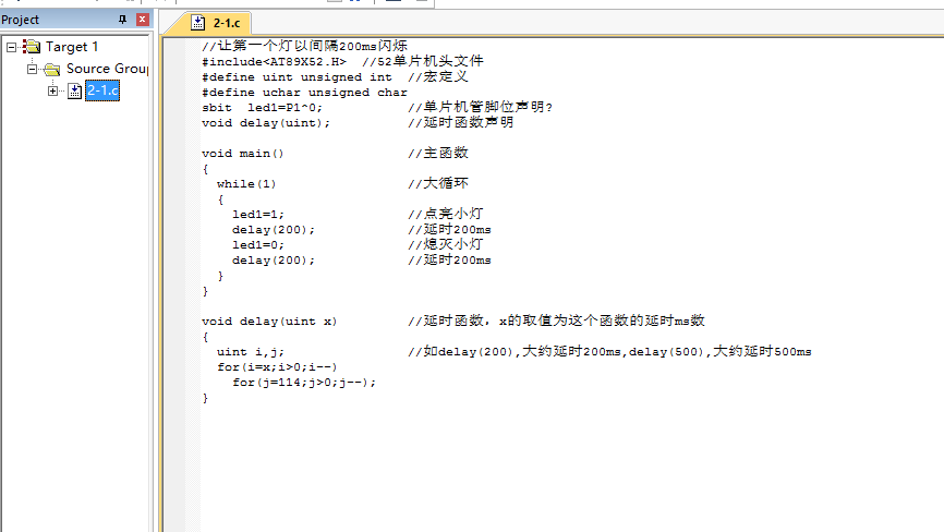

ID:111337 发表于 2016-4-1 17:54
#include <AT89X52.h>
#define uint unsigned int
#define uchar unsigned char
void display(uint);
void delay(uint);
uchar code Seg_disp[]={0xC0,0xF9,0xA4,0xB0,0x99,0x92,0x82,0xF8,0x80,0x90};
uint num;
void init()
        EA=1;
        EX0=1;
        ET0=1;
        IT0=1;
        TMOD=0x01;
        TL0=(65536-10000)%256;
        TH0=(65536-10000)/256;
        TR0=0;
void main()
         init();
                  display(num);
void timer_0() interrupt 1
        TL0=(65536-1000)%256;
        TH0=(65536-1000)/256;
        num++;
        if(num==10000)num=0;
void INT0P() interrupt 0
        if(F0==0)   //F0&Ecirc;&Ccedil;±ê&Ouml;&frac34;&Icirc;&raquo;&pound;&not;0&acute;ú±í&Ecirc;&Ccedil;&micro;&Uacute;&Ograve;&raquo;&acute;&Icirc;°&acute;&frac14;ü&pound;&not;1&acute;ú±í&micro;&Uacute;&para;&thorn;&acute;&Icirc;°&acute;&frac14;ü
                        F0=1;
                        num=0;
                        TR0=1;  //&frac12;&laquo;&para;¨&Ecirc;±&AElig;÷T0&micro;&Auml;&iquest;&ordf;&Ecirc;&frac14;&acute;ò&iquest;&ordf;
        else
                        TR0=0;
                        F0=0;
void display(uint a)
        P0=0xff;
        P2=0x08;
        P0=Seg_disp[a%10];
        delay(5);
        P0=0xff;
        P2=0x04;
        P0=Seg_disp[a%100/10];
        delay(5);
        P0=0xff;
        P2=0x02;
        P0=Seg_disp[a%1000/100];
        delay(5);
        P0=0xff;
        P2=0x01;
        P0=Seg_disp[a/1000];
        P0=P0&0x7f;
        delay(5);
void delay(uint z)
        uint x,y;
        for(x=z;x>0;x--)
                for(y=114;y>0;y--);
ID:111337 发表于 2016-4-1 17:50
程序不难,但都有注释
