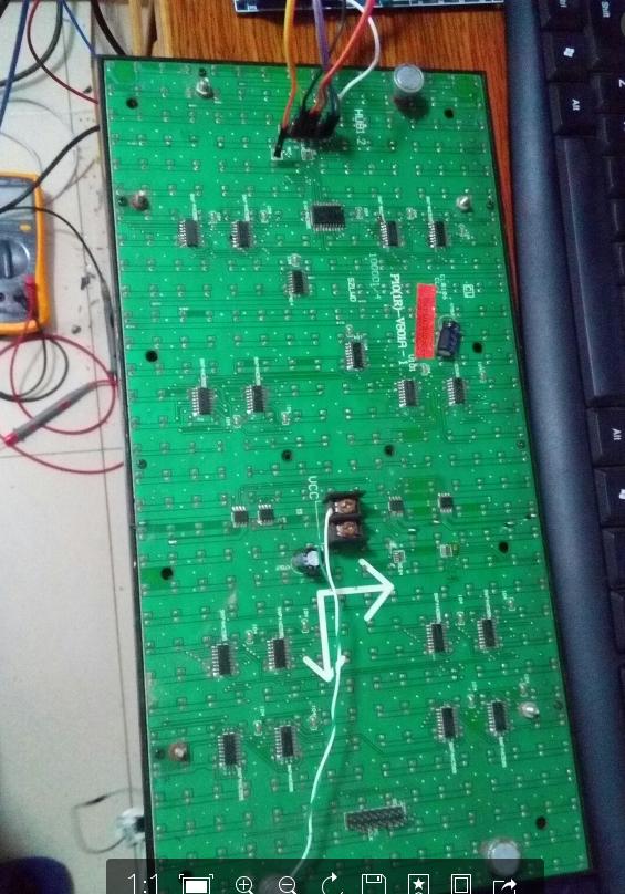

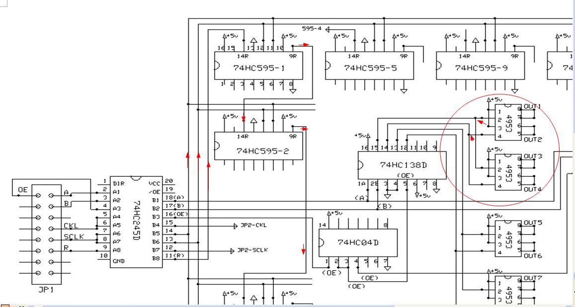

求个led广告屏单元的51程序
查看数: 3319 | 评论数: 2 | 收藏 1
发布时间: 2016-4-15 22:58
高好几天了,还是不来事。led广告屏是p10(间隔10mm)的单色(红色),点阵为16*32.列驱动是74hc595,行驱动靠74hc138译码器(3-8译码器)驱动电源ic开关。如果是简单的行列驱动也不麻烦。麻烦的是行只能选4种(也就 ...

这东西我玩过,程序如下:
#include <reg52.h>
#include <intrins.h>
#define uchar unsigned char
#define uint unsigned int
#define NOP     _nop_()
sbit OE     = P1^0;
sbit A1     = P1^4;
sbit B1     = P1^5;
sbit SHCP=P1^6;    //11脚SHCP    移位时钟
sbit STCP=P1^7;    //12脚STCP    锁存时钟
sbit DATA=P3^1;           //数据输入
uchar code table[10][32]=
{{0xFE,0xF7,0xBD,0xF7,0xC8,0x77,0xDB,0x77,0xF8,0x01,0xFB,0x77,0x18,0x37,0xDB,0x57,
  0xD0,0x57,0xDE,0x77,0xDD,0x77,0xD5,0x77,0xCB,0x77,0xD7,0x77,0xED,0x57,0xFE,0xEF},            //谢
{ 0xFE,0xF7,0xBD,0xF7,0xC8,0x77,0xDB,0x77,0xF8,0x01,0xFB,0x77,0x18,0x37,0xDB,0x57,
};          //谢
//数据串行输入
void serial_input(uchar dat)
        uint m;
                for(m=0;m<8;m++)
                        if(dat & 0x80)
                                DATA=1;
                        else
                                 DATA=0;
                        SHCP=0;
                        SHCP=1;
                                        NOP;
                        NOP;
                        SHCP=0;
                        NOP;
                        NOP;
                        dat=dat<<1;
//并出
void serial_output()
        STCP=1;
        NOP;
        NOP;
        STCP=0;
//行显控制
void HC138_scan(uchar temp)
   OE=1;
   A1=0x01 & temp;
   B1=0x01 &(temp>>1);
//整屏显示
void display()
        uint i,j,k;
        for(k=0;k<4;k++)                  //显示的四行
                        for(j=0;j<2;j++)          //显示3、4列
                                for(i=0;i<2;i++)      // 显示1、2列
                                        serial_input(table[j][3*8+2*k+i]);
                                        serial_input(table[j][2*8+2*k+i]);
                                        serial_input(table[j][1*8+2*k+i]);
                                        serial_input(table[j][0*8+2*k+i]);
                                serial_output();
                                HC138_scan(k);
void main()
                display();
