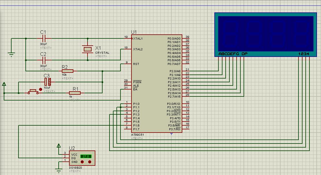

求程序,依照下图(基于基于数字温度传感器的数字温度计)
查看数: 4259 | 评论数: 3 | 收藏 0
发布时间: 2016-12-25 13:55
用到DS18B20、单片机AT89C51。哪位大神按我的图,给下程序呢,谢谢,思密达~

#include <avr/io.h>
#include <util/delay.h>
#define uchar unsigned char
#define uint unsigned int
#define BUS PORTC

#define s_digit1 sbit(5,PORTC)
#define c_digit1 cbit(5,PORTC)
#define s_digit2 sbit(4,PORTC)
#define c_digit2 cbit(4,PORTC)
#define out PORTC
#define DQ_IN DDRA&=~(1<<7)
#define DQ_OUT DDRA|=(1<<7)
#define S_DQ sbit(7,PORTA)
#define C_DQ cbit(7,PORTA)
#define DQ pin(7,PINA)

uchar readtemp(void)
{ uint t;
init_ds18b20();
// Convert          转换
writecommand(0xCC);
writecommand(0x44);
init_ds18b20();
// Read Scratch memory area                读暂存区
writecommand(0xCC);
writecommand(0xBE);
a = readbyte();
b = readbyte();
t = b;
t <<= 8;
t = t|a;
tt = t*0.0625;
return(tt);
