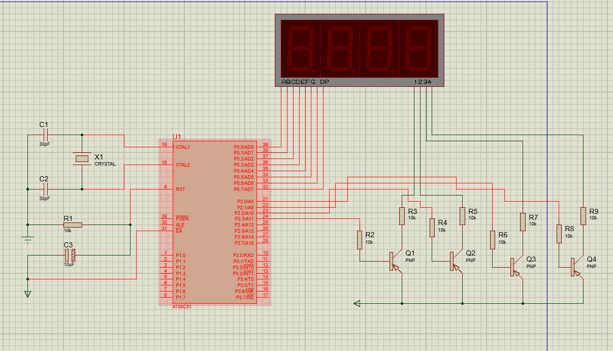

四位数秒器陈序及电路图,有点简陋
查看数: 3424 | 评论数: 0 | 收藏 1
发布时间: 2017-4-25 20:03
#include<reg52.h> #define uchar unsigned char #define uint unsigned int uchar code SegCode[]= {0xC0,0xF9,0xA4,0xB0,0x99,0x92,0x82,0xF8,0x80,0x90}; uchar code BitCode[]={0xfe,0xfd,0xfb,0xf7} ...
