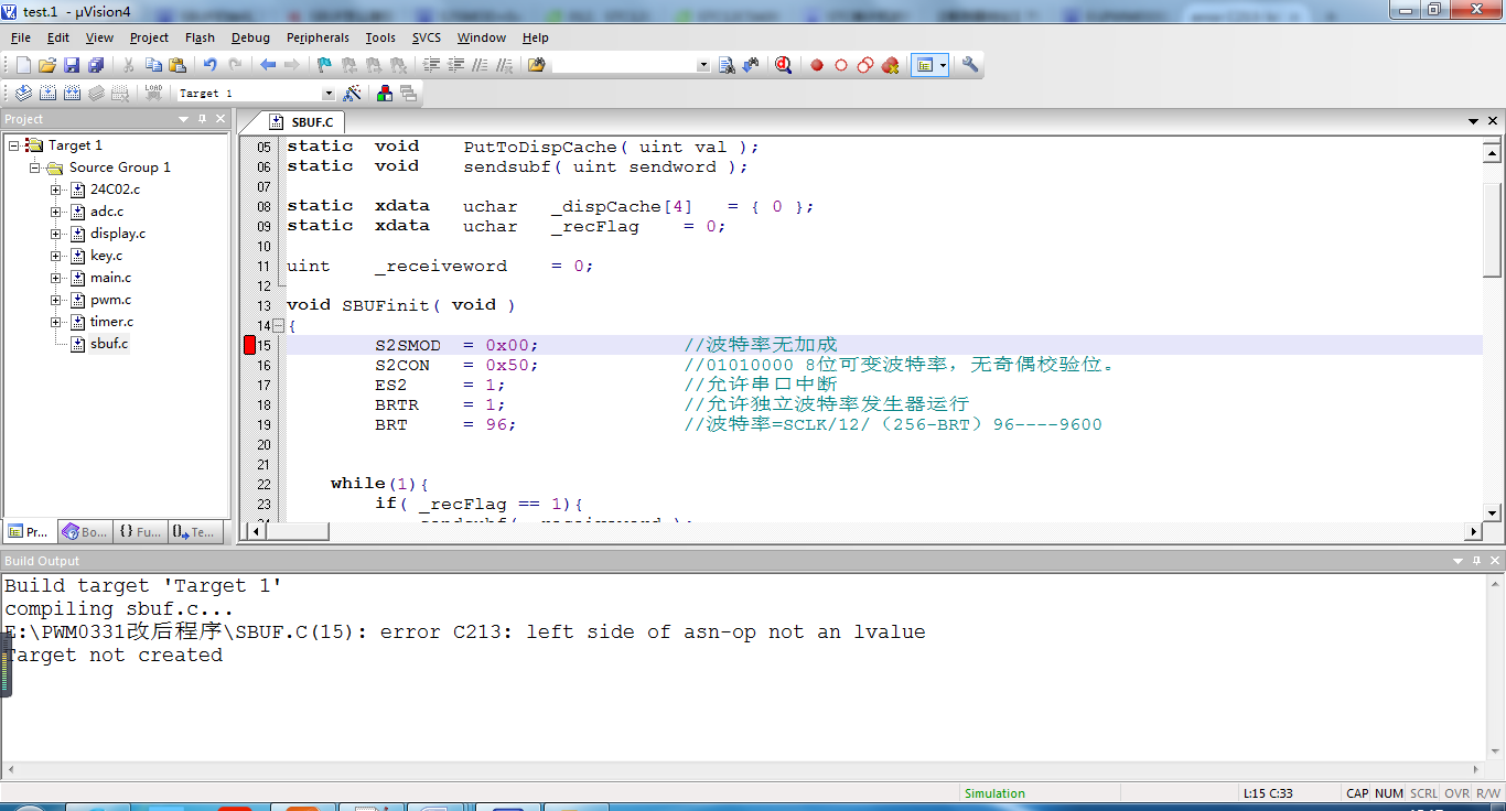

error C213: left side of asn-op not an lvalue单片机keil报错
查看数: 6447 | 评论数: 1 | 收藏 0
发布时间: 2017-6-4 15:25
keil报错:error C213: left side of asn-op not an lvalue 单片机源程序: #include "STC12C5A.h" #include "iodefine.h" static    void    DisplayProcess( void ); stati ...
ID:264442 发表于 2017-12-20 20:13
S2CON &= ~S2RI
