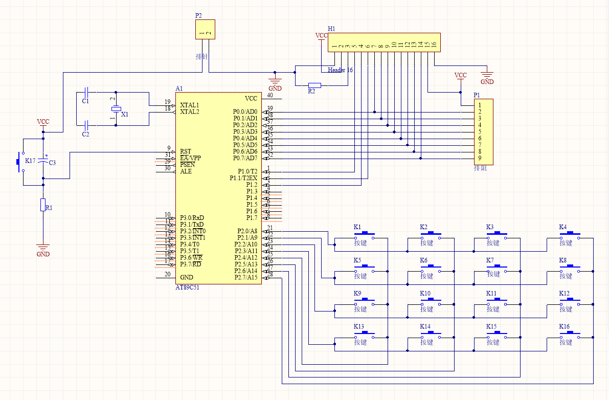

简易计算器设计
查看数: 2557 | 评论数: 0 | 收藏 0
发布时间: 2017-11-20 20:19
#include<reg51.h>   //í·???t #define uint unsigned int #define uchar unsigned char sbit lcden=P1^1; //LCD1602????òy?? sbit rs=P1^0; sbit rw=P1^2; sbit busy=P0^7;//LCD?| ...
