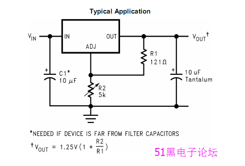

LM1084引脚图+电路与英文资料
查看数: 19129 | 评论数: 1 | 收藏 0
发布时间: 2017-11-22 11:06
LM1084的英文介绍 The LM1084 is a regulator with a maximum dropout of 1.5 V at 5 A of load current. The device has the same pinout as TI's industry standard LM317. Two resistors are required to set ...
