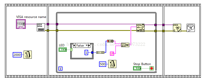

const unsigned char LED = 13;
byte comData;     //定义从串口接收过来的数据
void setup() {
  // put your setup code here, to run once:
  Serial.begin(9600);       //初始化串口,波特率设置为9600
  pinMode(LED, OUTPUT);     //设置数字引脚为输出模式
void loop() {
  // put your main code here, to run repeatedly:
  if (Serial.available() > 0)   //检测串口缓冲区是否有数据
    comData = Serial.read();
    if (comData == 0x01)        //接收到该命令,则执行关灯
      digitalWrite(LED, LOW);
    if (comData == 0x02)        //接收到该命令,则执行开灯
      digitalWrite(LED, HIGH);
