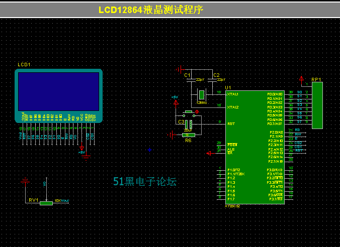

- 内容:无字库12864测试程序(纵向取模。字节倒序)
- #include <reg52.h>
- #define uint unsigned int
- #define uchar unsigned char
- #define Disp_On 0x3f //显示命令
- #define Disp_Off 0x3e //关闭命令
- #define Col_Add 0x40 //起始列地址
- #define Page_Add 0xb8 //起始页地址
- #define Start_Line 0xc0 //起始行地址
- #define Lcd_Bus P0 //MCU P0<---> LCM
- sbit RS = P2^0; //RS=1时为数据操作,RS=0时为命令操作
- sbit RW = P2^1; //RW=1时为读选通,RW=0时为写选通
- sbit E = P2^2; //E下降沿时,数据写入驱动器,E为高电平时,数据被读出
- sbit Mcs = P2^3; //Master chip E,右半屏-CS2
- sbit Scs = P2^4; //Slave chip E,左半屏-CS1
- sbit RST = P2^5; //液晶模块复位控制管脚
- char code ce[] = {
