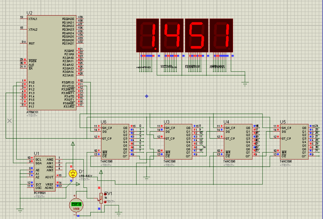

基于89c51的电压表设计(带仿真图和源程序)
#include<reg52.h>
#define uint unsigned int
#define uchar unsigned char
uchar code table[]={0x3f,0x06,0x5b,0x4f,0x66,0x6d,0x7d,0x07,
                                        0x7f,0x6f,0x77,0x7c,0x39,0x5e,0x79,0x71};
sbit scl=P1^0;
sbit sda=P1^1;
sbit st=P1^3;
uchar num,ge,shi,bai,qian,xge,xbai,xshi,xqian;
void delay()
void delayms(uint x)
        uint y;
        for(;x>0;x--)
                for(y=114;y>0;y--);
void init()
        sda=1;
        delay();
        scl=1;
        delay();
        st=0;
        SCON=0;
        EA=1;
        ES=1;
        TI=0;
void chulishu(uint shu)
        qian=shu/1000;
        bai=shu%1000/100;
        shi=shu%100/10;
        ge=shu%10;
        xge=table[ge];
        xshi=table[shi];
        xbai=table[bai];
        xqian=table[qian]|0x80;
void start()
        sda=1;
        delay();
        scl=1;
        delay();
        sda=0;
void stop()
        sda=0;
        delay();
        scl=1;
        delay();
        sda=1;
void respons()
        uchar i=0;
        scl=1;
        delay();
        while((sda==1)&(i=250))
                i++;
        scl=0;
        delay();
void writebyte(uchar date)
        uchar i,temp;
        temp=date;
        for(i=0;i<8;i++)
                temp=temp<<1;
                scl=0;
                delay();
                sda=CY;
                delay();
                scl=1;
                delay();
        scl=0;
        delay();
        sda=1;
        delay();
uchar readbyte()
        uchar i,k;
        scl=0;
        delay();
        sda=1;
        for(i=0;i<8;i++)
                scl=1;
                delay();
                k=(k<<1)|sda;
                scl=0;
                delay();
        delay();
        return k;
bit dac_out(uchar date)           //write_add
        start();
        writebyte(0x90+0);
        respons();
           writebyte(0x40);
        respons();
        writebyte(date);
        respons();
        stop();
        return(1);
bit adc_read(uchar com)
        start();
        writebyte(0x90+0);
        respons();
        writebyte(com);
        respons();
        start();
        writebyte(0x90+1);
        respons();
        num=readbyte();
        stop();
        return(1);
void main()
        uint aa;
        //bb=1234;
        init();
                if (adc_read(0x00));
        //        if (dac_out(num));
                dac_out(num);
                aa=num*19.61;
                chulishu(aa);
                SBUF=xge;
                delayms(1);
                SBUF=xshi;
                delayms(1);
                SBUF=xbai;
                delayms(1);
                SBUF=xqian;
                delayms(1);
                st=0;
                st=1;
void ser0() interrupt 4
        TI=0;
