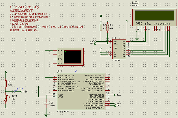

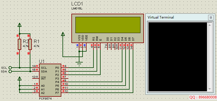

NTC热敏电阻测温的Proteus仿真与Arduino源码
ID:149389 发表于 2018-5-25 20:51 | 只看该作者 回帖奖励 |倒序浏览 |阅读模式
arduino源码:
  1. /*********************************************************
  2. *         Rt= 10K                RES=4700
  3. *   GND----/\/\/\/\----/\/\/\/\----VCC=5V
  4. * Rt = R *EXP(B*(1/T1-1/T2))
  5. * 对上面的公式解释如下:
  6. *
  7. * 1.Rt 是热敏电阻在T1温度下的阻值;
  8. * 2.R是热敏电阻在T2常温下的标称阻值;
  9. * 3.B值是热敏电阻的重要参数;
  10. * 4.EXP是e的n次方;
  11. * 5.这里T1和T2指的是K度即开尔文温度,K度=273.15(绝对温度)+摄氏度;
  12. *********************************************************/
  13. #include <math.h>
  14. #define RES 4700
  15. #include <Wire.h>
  16. #include <LiquidCrystal_I2C.h>
  17. LiquidCrystal_I2C lcd(0x27,16,2);  // set the LCD address to 0x27 for a 16 chars and 2 line display
  18. double Water_temp;
  19. void setup(){
  20.   Serial.begin(9600);
  21.   lcd.init();                      // initialize the lcd
  22.   // Print a message to the LCD.
  23.   lcd.backlight();
  24.   lcd.clear();
  25.   lcd.setCursor(0, 0);
  26.   lcd.print("Temperature ");
  27. }
  28. void loop(){
  29.   double AD_val=analogRead(0);        //0-1023的范围
  30.   double GetVoltage=(AD_val/1023)*5.0;        //采样电压值
  31.   // 欧姆定律 Rt/RES=GetVoltage/(5.0-GetVoltage),电流一致
  32.   double Rt=GetVoltage*RES/(5.0-GetVoltage);
  33.   //热力学绝对温度
  34.   //T1=1/(ln(Rt/R) /B + 1/T2   )
  35.   // Serial.println( 1/(  log(Rt/RES) /3000 + 1/(25+273.15)   ));
  36.   Water_temp=1/(log(Rt/10000) /3950 + 1/(25+273.15))-273.15;
  37.   if(Water_temp>-100.0)
  38.   {
  39.     Serial.print("RES= ");
  40.     Serial.print(RES);
  41.     Serial.print(" RT=  :");
  42.     Serial.println(Rt);
  43.     Serial.print("The temperature is :");
  44.     Serial.print(Water_temp);
  45.     Serial.println(" ~C");
  46.     lcd.setCursor(0, 1);
  47.     lcd.print("T1=");
  48.     lcd.print(Water_temp);
  49.     lcd.print("  ");
  50.   }
  51.   else
  52.   {
  53.     Serial.println("Error! check sensor!");
  54.   }
  55.   delay(1000);
  56. }

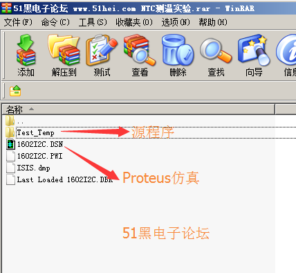

NTC测温实验.rar (37.16 KB, 下载次数: 176)
