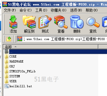

关于STM32F030的具体模板,共开发者参考
- STM32F030C8T6模板
- 时钟都在system_stm32f0xxx.里设定。用那个开那个,输出都是48MHZ,最大频率,可以在里面改变大小频率
- #define PLL_SOURCE_HSI // HSI (~8MHz) used to clock the PLL, and the PLL is used as system clock source(~ 8MHz)
- //#define PLL_SOURCE_HSE // HSE (8MHz) used to clock the PLL, and the PLL is used as system clock source
- //#define PLL_SOURCE_HSE_BYPASS // HSE bypassed with an external clock (8MHz, coming from ST-Link) used to clock
- 使用内部时钟 48MHZ

所有资料51hei提供下载:
工程模板-F030.zip
(297.96 KB, 下载次数: 218)
