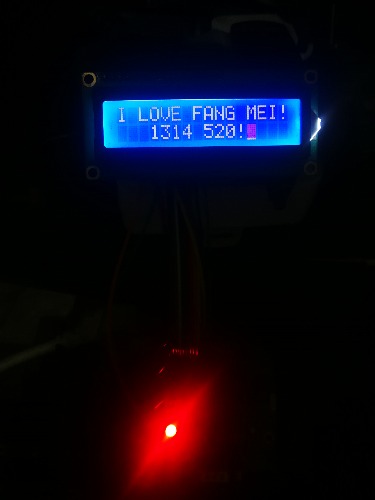

STC89C52驱动LCD1620
ID:32788 发表于 2018-11-18 15:32 来自手机 | 只看该作者 |只看大图 回帖奖励 |倒序浏览 |阅读模式
#include<reg52.h>
#define uchar unsigned char
#define uint unsigned int
uchar code table[]="I LOVE FANG MEI!";
uchar code table1[]="1314 520!";
sbit lcden=P3^4;
sbit lcdrs=P3^5;
uchar num;
void delay(uint z)
      uint x,y;
          for(x=z;x>0;x--)
          for(y=110;y>0;y--);
void write_com(uchar com)
  lcdrs=0;
  P0=com;
  delay(5);
  lcden=1;
  delay(5);
  lcden=0;
void write_data(uchar date)
      lcdrs=1;
          P0=date;
          delay(5);
          lcden=1;
          delay(5);
          lcden=0;
void init()
         lcden=0;
         write_com(0x38);
         write_com(0x0f);
         write_com(0x06);
         write_com(0x01);
         write_com(0x80);
void main()
                  init();
                        for(num=0;num<16;num++)
                        write_data(table[num]);
                        delay(300);
                        write_com(0x80+0x40+3);
                        for(num=0;num<9;num++)
                          write_data(table1[num]);
                          delay(300);
                while(1);
