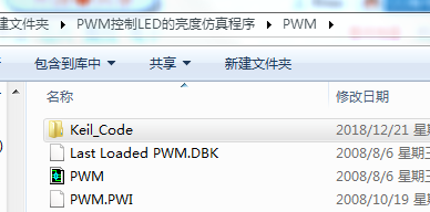

ID:451766 发表于 2018-12-21 20:25 | 显示全部楼层 |阅读模式
#include "reg51.h"
unsigned int cd,dd;
unsigned char cc,ee;
sbit LED=P2^0;
void led_int() interrupt 1 using 0
        TH0=0xf1;
        TL0=0xf1;
        TR0=1;
        dd++;
        if(dd==11)
                if((cc==0x50)&&(ee==0)){cd=0;}
                if((cc==0)&&(ee==0x50)){cd=1;}
                if(cd){cc++;ee--;}
                else {cc--;ee++;}
                dd=0;
void delay(unsigned int i)
        unsigned int j;
        while(i--)
                for(j=0;j<0x20;j++);
void main()
        cc=0;
        ee=0x50;
        TMOD=0x01;
        TH0=0xf0;
        TL0=0xf0 ;
        EA=1;
        ET0=1;
        TR0=1;
                LED=0;
                delay(ee);
                LED=1;
                delay(cc);
PWM控制LED的亮度仿真程序.7z (977.34 KB, 下载次数: 70)
