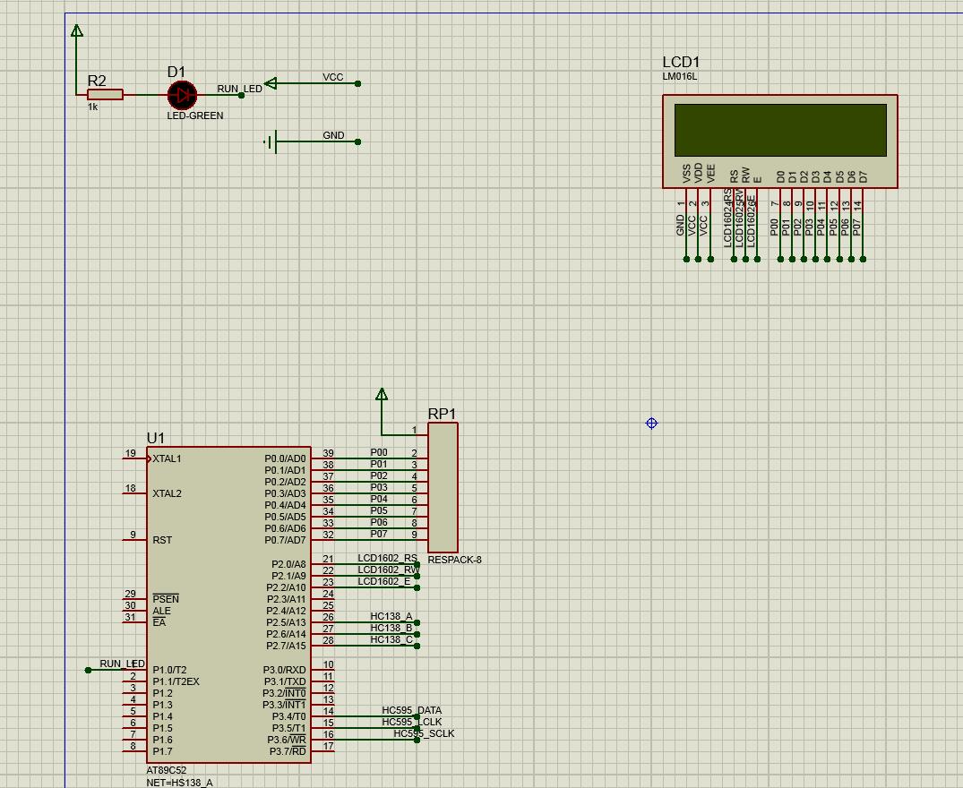

#include "Config.h"
#include <intrins.h>
sbit RS = P2^0;
sbit RW = P2^1;
sbit E= P2^2;
void LCD1602_delay_10us(unsigned char i)
unsigned char j;
while(i--)
for(j=0;j<10; j++)
void LCD1602_delay_1ms(unsigned char i)
unsigned char j;
while(i--)
for(j=0;j<125;j++)
void LCD1602_Write_Cmd(unsigned char cmd)
LCD1602_delay_10us(5);
E=0;
RS=0;
RW=0;
LCD_PORT=cmd;
LCD1602_delay_10us(5); //>40us
E=1;
LCD1602_delay_1ms(2); //>150us
E=0;
LCD1602_delay_10us(4); //>25+10us?
void LCD1602_Write_Dat(unsigned char dat)
E=0;
RS=1;
RW=0;
LCD_PORT = dat;
E=1;
E=0;
void LCD1602_Addr_x_y(unsigned char x,bit y)
unsigned char temp=0x80;
if(y)
temp|=0x40;
temp|=x;
LCD1602_Write_Cmd(temp);
void LCD1602_Show_Char(unsigned char x,bit y,unsigned char p)
LCD1602_Addr_x_y(x,y);
LCD1602_Write_Dat(p);
void LCD1602_Show_String(unsigned char x,bit y,char *ptr,unsigned char data_len)
unsigned char i;
for (i=0;i<data_len;i++)
LCD1602_Show_Char(x++,y,*(ptr+i));
void LCD1602_Init(void)
LCD1602_delay_1ms(1500);
LCD1602_Write_Cmd(0x38);
LCD1602_delay_1ms(5);
LCD1602_Write_Cmd(0x08);
LCD1602_Write_Cmd(0x06);
LCD1602_Write_Cmd(0x0c);
LCD1602_Write_Cmd(0x01);
