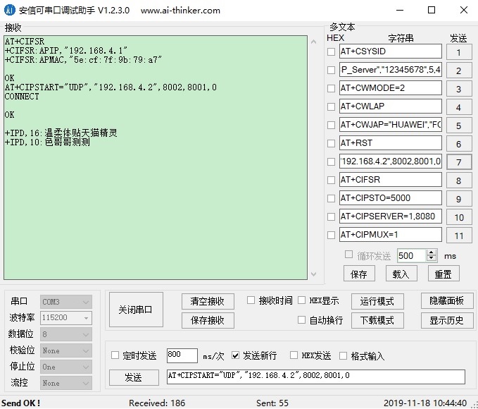

3. 用flash_download_tools_v3.6.6刷好固件
4. 用 faithinker_serial_tool_v1.2.3  AT指令测试
UDP 通信连接测试
AT+RST
AT+CWMODE=2 //设置 AP
//OK
AT+CWSAP_DEF="TCP_Server","12345678",5,4 //设置AP
//OK
AT+CIFSR //查询 IP
//+CIFSR:APIP,"192.168.4.1"
//+CIFSR:APMAC,"a2:20:a6:19:c7:0a"
//OK
AT+CIPSTART="UDP","192.168.4.2",8002,8001,0 //开启UDP 连接
//CONNECT
//OK

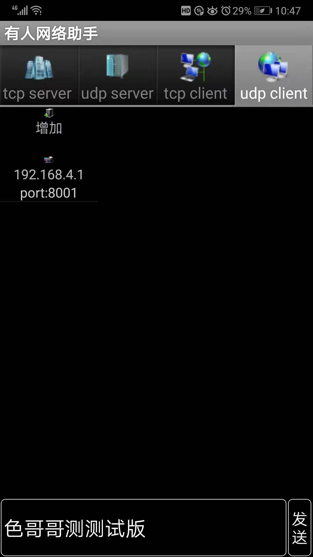

手机端测试
手机端测试

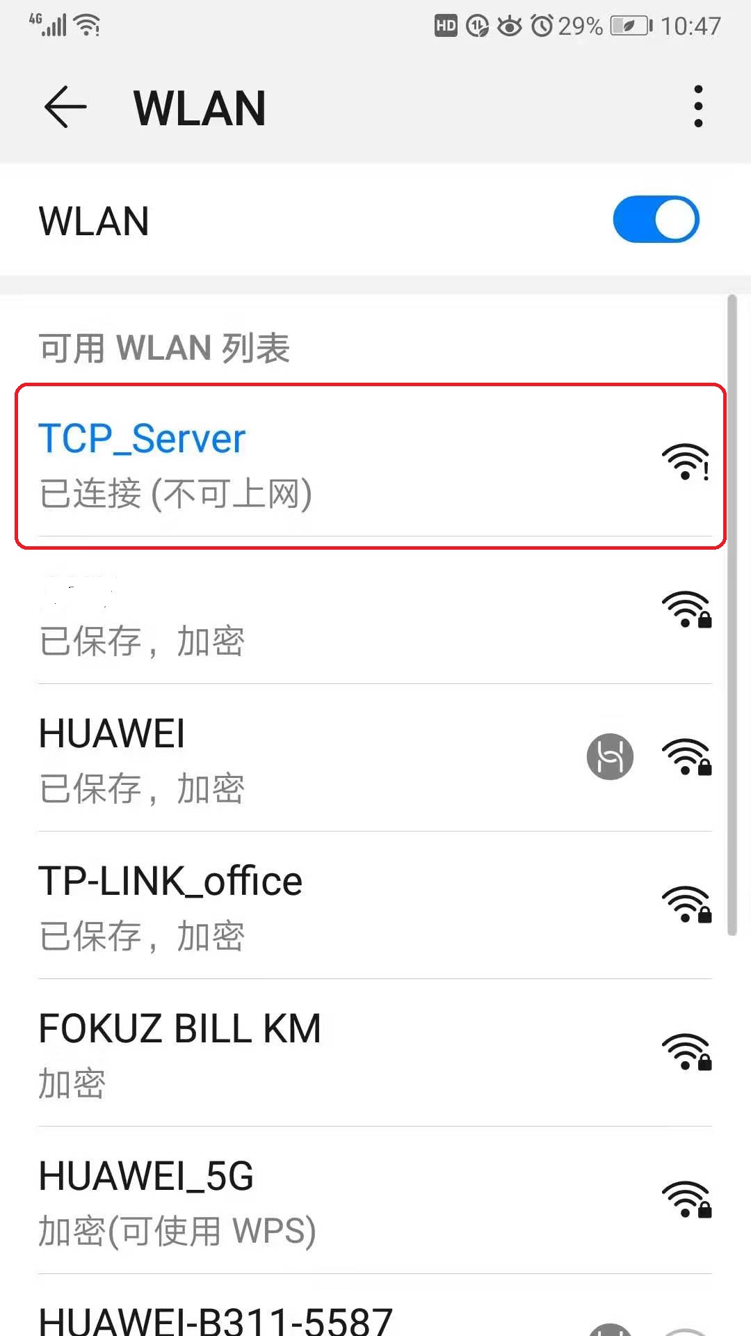

AP连接
AP连接
PC端串口显示
PC端串口显示
