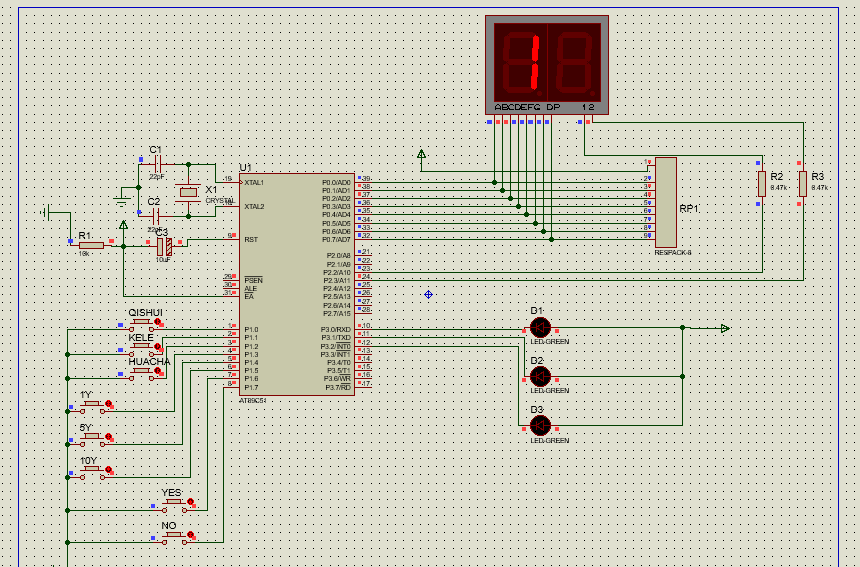

单片机自动售货机Proteus仿真程序
源码
#include<reg52.h>
sbit key1=P1^0;
sbit key2=P1^1;
sbit key3=P1^2;
sbit key4=P1^3;
sbit key5=P1^4;
sbit key6=P1^5;
sbit key7=P1^6;
sbit key8=P1^7;
sbit led1=P3^0;
sbit led2=P3^1;
sbit led3=P3^2;
int step=1;
int price=0;
int num=1;
int table1[]={0x3F,0x06,0x5B,0x4F,0x66,0x6D,0x7D,0x27,0x7F,0x6F}; //数码管显示0-9
unsigned char dispbuf[8]={0,0,0,0,0,0,0,};
int table2[]={0xe0,0xc0,0xa0,0x80,0x20};//控制退币
int total_money=0;//所选商品总价格
int back_money=0; //应退金额
int in_money=0;

显示函数?每一步显示不同的内容
void display ()
if(step==1)
P2=0x04;
totalmoney();
P0 =table1[total_money%10];
delay(80);
P2 = 0x08;
P0 = table1[total_money/10];
delay(80);
else if(step==2)
P2=0x04;
inmoney();
P0=table1[in_money%10];
delay(80);
P2=0x08;
P0=table1[in_money/10];
delay(80);
else if(step==3)
P2=0xf0;
backmoney();
if(back_money<0)
step--;
P0=table1[in_money];
if(back_money>=0)
P2=0x04;
backmoney();
P0=table1[back_money%10];
delay(80);
P2=0x08;
P0=table1[back_money/10];
delay(80);
reset();
else
P0=table1[1];
//主函数
void main()
choose();
apply();
display();
