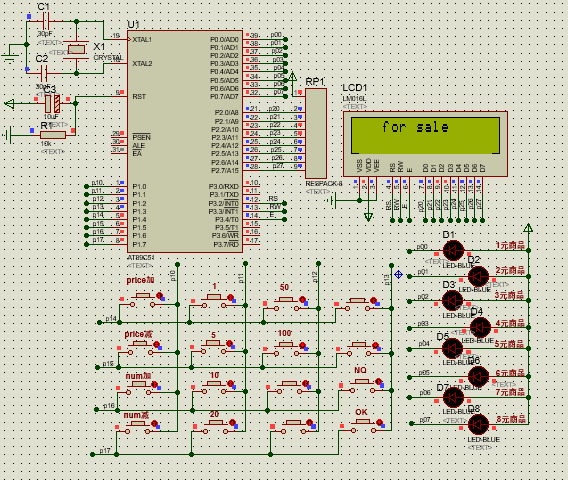

源代码如下(附件在后面供下载)
#include<reg51.h>

/*****************main********************************/
void main()
unsigned char ok = 0, water_type = -1, water_is_choose = 0;
char water_count = 0;
unsigned int flag = 0, money = 0, need_money;
lcd_1602_init();
again:
ok = 0; water_type = -1; water_count = 0; water_is_choose = 0;
flag = 0; money = 0; need_money = 0;
lcd1602_info_display(WAIT_SALE, 0, 0);
while(!ok) //choose the water and count
flag=key();
if(flag)
switch(e) //不同的按键进行不同的操作
case(0x00):
water_type++;
water_is_choose = 1;
if(water_type == 8)
water_type = 0;
P0 = water_change(0xff, water_type);
break;
case(0x01):
water_type--;
if(water_type == -1 || water_type == -2)
water_type = 7;
break;
case(0x02):
if(water_is_choose == 1)
water_count++;
if(water_count > water_total[water_type])
water_count = water_total[water_type];
break;
case(0x03):
water_count--;
if(water_count < 0)
water_count = 0;
break;
case(0x0e): // 返回
goto again;
break;
case(0x0f): // 确认
ok=1;
break;
default:
break;
lcd_1602_saling(water_type, water_count);
//choose ok: calculate the money //计算钱的总数
need_money = water_count * water_price[water_type];
lcd_1602_inputing(need_money, money);
ok = 0;
while(!ok) //get money
flag=key();
if(flag)
switch(e)
case(0x04):
money=money+1;
break;
case(0x05):
money=money+5;
break;
case(0x06):
money=money+10;
break;
case(0x07):
money=money+20;
break;
case(0x08):
money=money+50;
break;
case(0x09):
money=money+100;
break;
case(0x0e): //back lcd1602_info_display(CHANGE, money, CANCLE);
P0 = 0xff;
delay1(50000);
goto again;
break;
default:
break;
//show money
lcd_1602_inputing(need_money, money); //投币系统
if(money >= need_money)
ok=0; //break and show back money
//show back money
lcd1602_info_display(CHANGE, money-need_money, NO_DATA);
out_water();
goto again;
