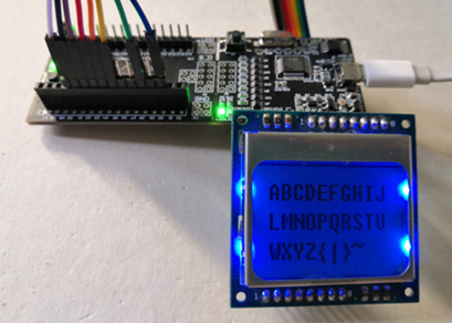

LCD5110显示屏是一款显示内容相对丰富,能耗相对比较低的显示器件,为实现显示功能它与SDK-HC89F0541开发板的连接关系为:
SEC  --- P2_4
RST  ---  P3_5
DC    ---  P3_4
SDI   ---  P3_3
SCK  ---  P1_6
LED  --- P1_7
为便于编程所作的输出高低电平的宏定义为:
#define LCD_LED_High()    LED=1
#define LCD_CLK_H           SCK=1
#define LCD_CLK_L           SCK=0
#define LCD_DIN_H           SDI=1
#define LCD_DIN_L           SDI=0
#define LCD_DC_H           DC=1
#define LCD_DC_L           DC=0
#define LCD_RST_H         RST=1
#define LCD_RST_L          RST=0
#define LCD_CS_H           SEC=1
#define LCD_CS_L            SEC=0

显示小写字符串
显示大写字符串
